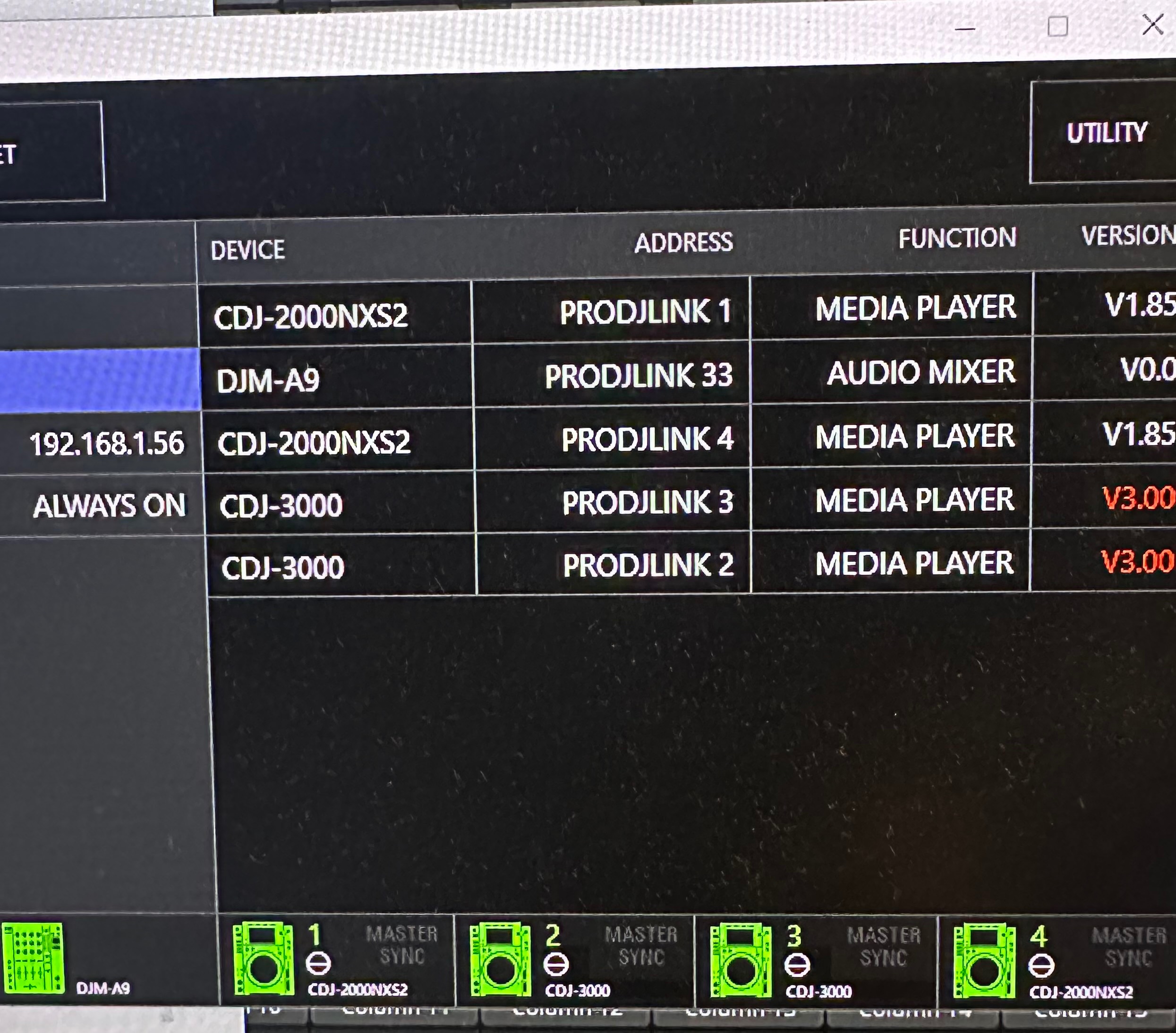

We have two cdj3000 and two cdj200nxs2
Firmware on the cdj3000 is 3.00, I have asked the tech to upgrade this firmware. The bridge app has these highlighted in red.
Firmware on the cdj2000 is 1.85, this is the latest available.

No time counters are working. And now that we update the firmware on the cdjs they won't turn green.
Posts: 7704
Re: Pioneer bridge sync problem
weird, the player status in your screenshots should also show if a player is playing,
