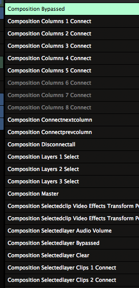

Okay, I got it installed. But when I go to EDIT KEYBOARD in SHORTCUTS (pull-down menu), I don't see "COMPOSITION POSITION" in the Shortcuts Tab.
This is what your YouTube video says:
This is what I see (Resolume 7):
HELP!
Go slow, STEP-BY-STEP INSTRUCTIONS, please!

No, the video is from a Resolume native solution.
You need to map the keyboard shortcuts yourself to make it work.
Click on the highlighted layer position slider, then hit your key and set the options.
Shortcut mode to mouse.
Repeat for the number of layers you want to control.

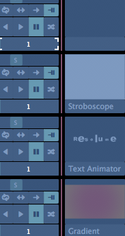

Okay, I figured out that you set ALL CHANNELS (Layers) to the SAME KEYBOARD DIGIT "1," so I did the same (correct if I did this wrong):

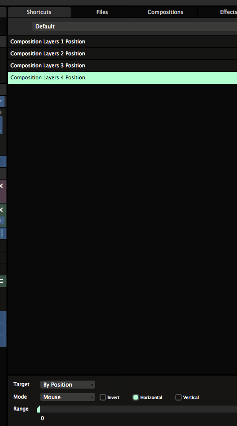

Next, I go to the SHORTCUTS tab and leave the setting at "POSITION," but change to "MOUSE."
In your YouTube video example, where the mini keyboard is displayed, I think you are HOLDING DOWN the "1" key. I do this, but then when I move the mouse, NOTHING HAPPENS in Arena.
I am back on Version 6 because you did not specify if this will work on Version 7.
Do I have to somehow SELECT WHICH LAYERS I want the mouse movement to control? Or was that already determined when I "EDIT KEYBOARD" and assigned "1" to each layer?

I said it's broken for audio in v7 and works fine in v6.Film35HD wrote: Wed Apr 22, 2020 14:37 I am back on Version 6 because you did not specify if this will work on Version 7.
Yes, the shortcuts define what you want to control.Do I have to somehow SELECT WHICH LAYERS I want the mouse movement to control? Or was that already determined when I "EDIT KEYBOARD" and assigned "1" to each layer?
The screenshots look fine, it should work on Audio-Video clips. Won't work on Sources.

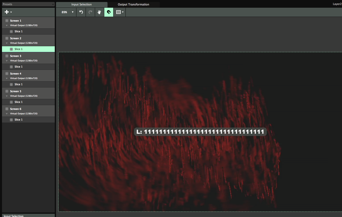

Zoltan,
How do I prevent the "L:11111111111" from coming onto the screen... this is obviously me holding down the "1" macro. This is only on the Arena 'Advanced Output' preview – I hope it does not go out to the SDI ports on the Blackmagic Design SDI card which feeds the video monitors and projectors.
If I can't prevent this, how do I 'clear' the screen?
