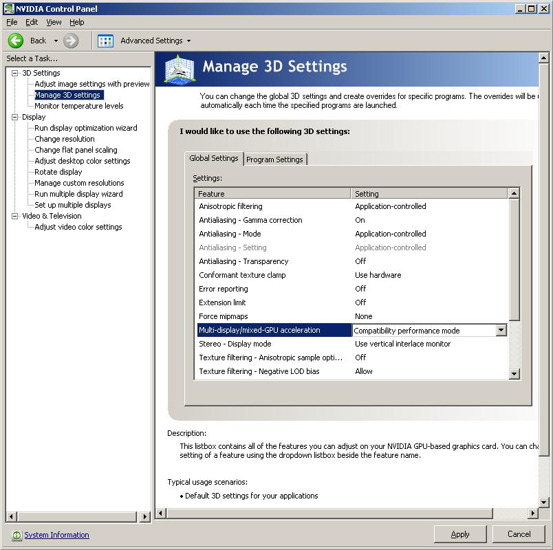

edwin
Posts: 1207
Re: No output on 2nd screen !
Post by edwin »
Hi There,
We did some tests with our own NVIDIA card and ran into the same problems a listed in this topic.
And after some tests we also changed the so called 'Multi-display/midex-GPU acceleration' setting in NVIDIA's control panel. This control panel can be found in Start->Control Panel->NVIDIA Control panel.
When this mode setting is set to 'Compatibility performance mode' everything seems to be working fine in Resolume 3. Untill we found how to get around this problem in the program ourselves we suggest trying to change this setting.
To change this do the following, close Resolume 3 if running, then open NVIDIA control panel and go to 3D Settings->Manage 3D settings. Then on the Global settings tab change the 'Multi-display/mixed-GPU acceleration' setting to 'Compatibility performance mode' and choose apply.
Restart Resolume and set your putput to your second display and see whether this helps.
Note this is a temporary fix, we will try fix this in the application ourselves to prevent users having to alter these settings themselves.
screenshot NVIDIA cotrol panel
