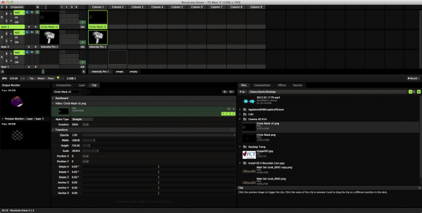

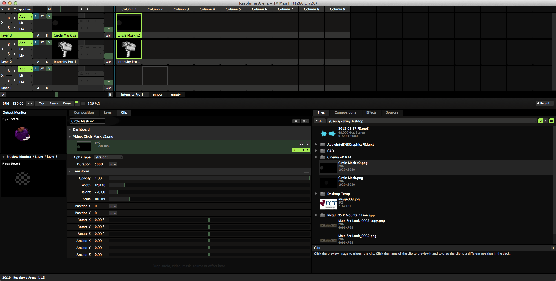

I followed you directions to the t and it worked for one layer, yet I need to run 2 years. the pictures show my setup. mask and video A and B. When the fader is on a or be, the mask works, but when I center the fader, the mask disappear on both videos and leaves me 2 videos running and no mask.
I want to run 2 layers of video with 2 different masks at the same time.
Untitled.tiff
Untitled.tiff (701.03 KiB) Viewed 10912 times
Untitled 2.tiff
Untitled 2.tiff (552.12 KiB) Viewed 10912 times
