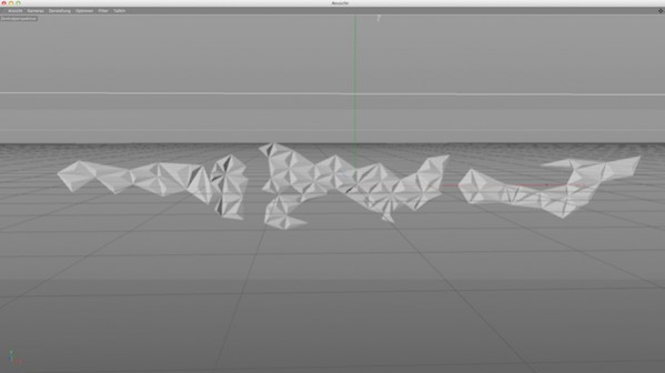

Step 5: Export a 3d mesh (Cinema4d, Blender or Aftereffects) as an .obj file.

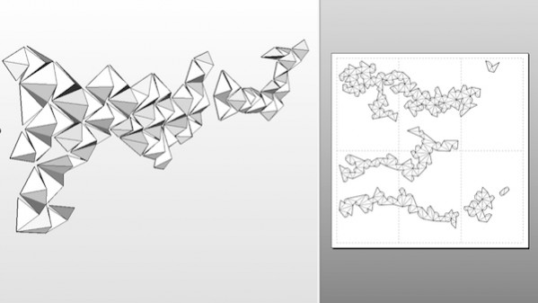

Step 7: Import or drag and drop the .obj File in the Pepakura window. You can rotate the camera view and change some adjustments.
Step 8: Next click on "unfold". You can notice that some edges of the model are open now. The software calculates the best way to cut the 3d model in a flat piece.
Step 9: Print the generated design and cut / plot it.

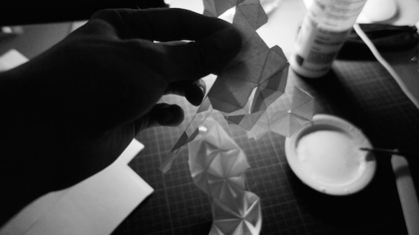

Step 10: Glue the parts together (this is the challenge!).

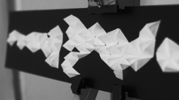

Step 11: Map it with any projection mapping tool that's called Resolume Arena 4.
