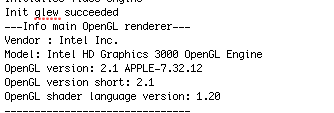

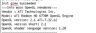

You can check the logfile to see if Resolume is using the Intel or the GTX...
Integrated Intel:
Discrete GPU (AMD in my case):

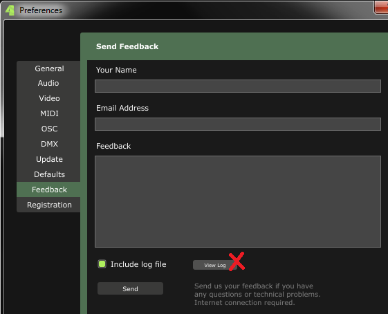

Question where can i find the log file in windows 8, I looked in the C:\User\{username}\AppData\Local folder but nothing to be seen of Resolume, please let me know.
Posts: 1627
Re: Problems with my Laptop ( Benchmark Low)
Hi Hive8... if you are unsure where to find the log.... just click here:
Greetings
hive8
Posts: 331
Location: Los Angeles
Post by hive8 »
HAHAHA i feel stupid now. Thank you
Great found it now appData/roaming/Resolume/
