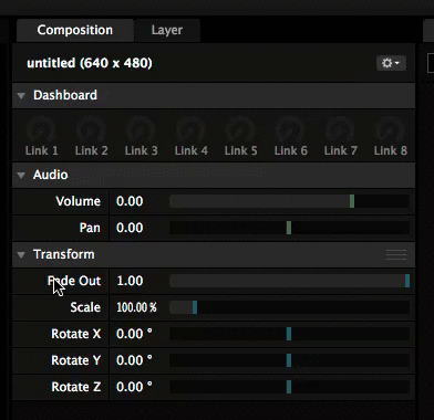

finding this simple task ineffective - i have the opacity parameter of stripper midi mapped to rotary #1 of the dashboard control on my master comp. backspace, delete, right click can't remove the mapping from either of the parameters in both normal and midi map mode. help!

A link to the dashboard can be removed by right-clicking on the parameter name ( so not the dashboard dial ).
