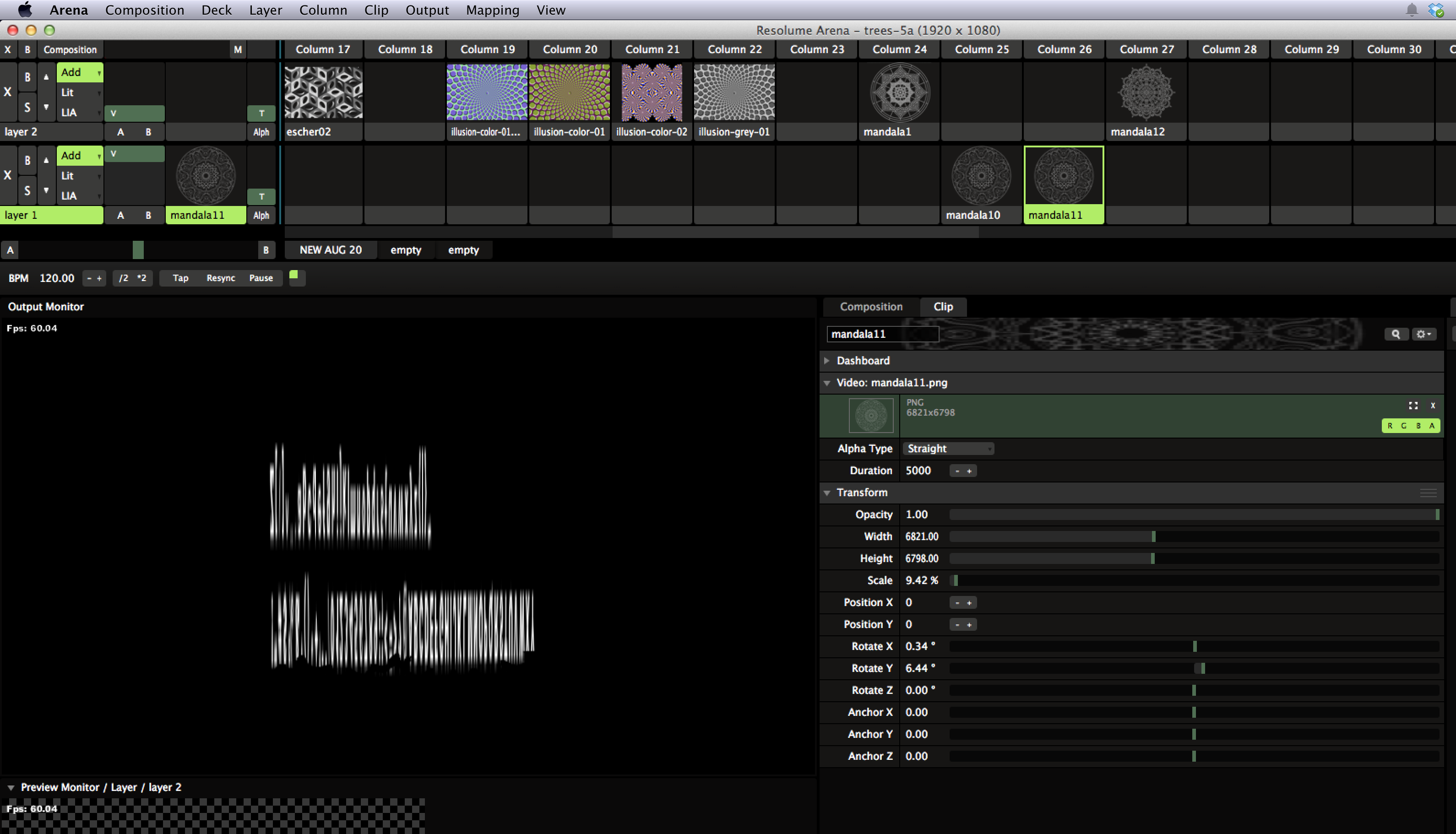

Using 4.1.11 on a MBP 15" Retina, I find the following error:
1. Open Arena with new show file.
2. Drag in 10-12 PNGs. If I drag in more than 5-10 at once, Arena crashes.
3. Drag in 5 PNGs at a time, most run fine.
4. A small percentage of the PNGs produce the error shown in the attached image.
5. If I remove the PNG causing this error, and then drag it back into a clip slot by itself, Arena crashes.
So, there's obviously something about a few of these PNGs that Arena really doesn't like. Can anyone help me to understand what that might be?
All PNGs in question are created in Photoshop and include an alpha channel, but are non-interlaced.
Any thoughts?

Looking at the pic you posted, your composition is 1920x1080 when the png file loaded in your clip is almost 7000x7000 and your scale is set to 9.42% so it looks like your trying to size a very large image down to fit into your composition, is that correct?
If you do a little search, there are quite a few posts on pngs and memory but the jest of it is that resolume is a 32-bit software and large png files are pretty taxing on the system so if you've a deck loaded with a bunch of really large png files you're bound to experience performance issues.
Are you zooming in on this type of png file to a point where you'd need to use a 6821x6798 file? If not, I would downsample these files to fit your composition better.
