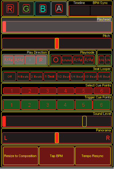

Currently I`m assembling a TouchOSC-Resolume template.
Its partly going to be an exact copy of the active clip transport controls.
I have assigned note values for all the buttons,an osc for the playhead and midi cc for the rest of the faders.Sending these messages are seamless,however,I have experienced a very odd occurrence with received updated values.
For example,after I assigned the 1/5 CC. value for the BPM/Timeline/Smpte selector,several cue select and cue trigger buttons lit up on resolume,and it seems to go crazy ,as if instead of the 1/5CC parameter,a whole range of commands would rage through it.
I have separated the whole range into 0-42,43-85,86-127,created a multi toggle with exclusive mode on,and assigned the first two ranges for the first two buttons(I dont need smpte).
I thought,assigning a range of CC values is the problem,so I filtered out the exact values for the BPM and Timeline,yet the craziness persisted,regardless that nothing else was assigned to 1/5 CC.
Then,I changed the midi channel to 2,which sorted this problem.It was odd though.I couldnt find an answer to how the hell was resolume able to be "controlled" that manner when all the CC and note values were different and I made sure I havent left any osc commands on those buttons accidentally.
The second oddity is that if I select a clip to preview-although mostly most of the parameters are updated(faders,buttons,toggles)-frequently I have to double click on the desired clip to get TouchOSC updated.Sometimes a single click is enough.
The third oddity is,that I have created six push buttons for cue point select,and a six button multi toggle(exclusive mode) for cue point trigger.
These are all have different notes assigned to them.When I click(or double click) on a loaded clip to preview,the 6th cue point select button is lit,also the 3rd of the cue point trigger button..
They are all on different midi channels with different note values,yet something is making them lit up.If I touch cue point select 6,then 5 lit up,if I touch 5,then 4 lit up,and it all descends until 1 is lit,and If I press it,it goes off.
Now,the icing on the cake is with the cue point trigger multitoggle(exclusive mode).As If I click on 2 that changes the play direction(assigned to a totally different channel and note value),and if I press cue point trigger 1,that somehow,turns off the active play direction button,it becomes unlit.

Setup:
Win7 32bit
Reso Arena 4.1.11.1.1.1.1.1.111111111 demo
quad core 2,4Ghz
4 gig ram
Ati Powercolor 6870(3 screens on mini-dp>VGAs)
Wireless USB dongle appr. 8cm away from the Ipad
Resolume sends odd control signals to TouchOSC
- Attachments
- LAyout Rightside.png (30.07 KiB) Viewed 5540 times

Let me explain this a bit better.I have assigned the cue point select osc parameter to a multipush containing six buttons.The values were 0-5 as provided in resolume.
When the template became active,without any particular reason,button 6 were lit.At this moment I had no cue points selected at all.When I pressed button nr6,nr 5 lit up,when i pressed 5 then 4,and this went on in descending order until I pressed 2,then button 1got lit,followed by pushing button1which resulted in the button being unlit.
Then changing the osc to midi note for each button would solve the problem...but only resulting in the exact very situation explained above.
