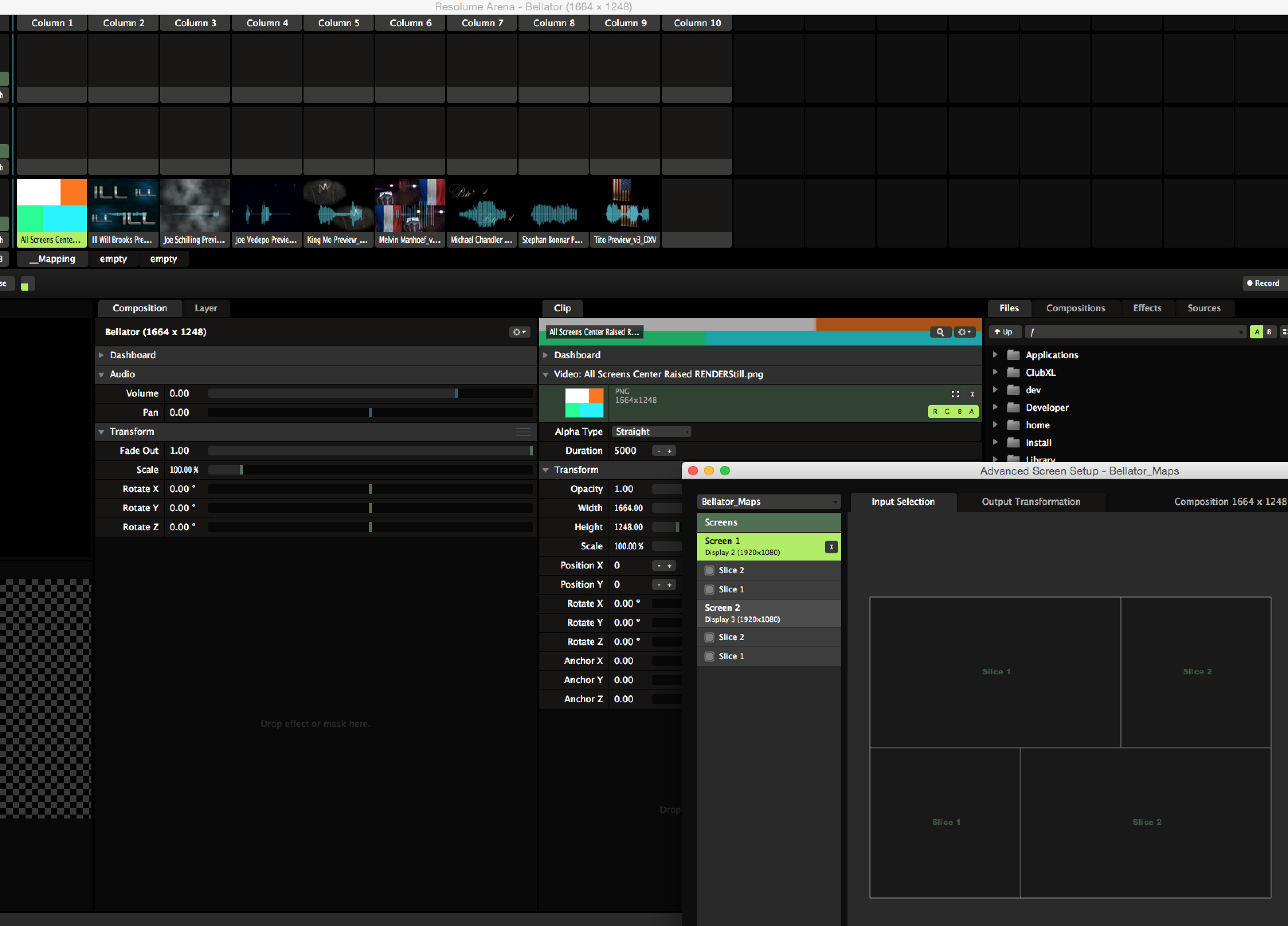

It's a very straight-forward comp. DXV codec. 1664x1248 (which is to accommodate the four screens I'm outputting to. (Inside of two 1920x1080 outputs)
All the clips are at 29.97.
Even with a slight fade, I still see a small amount of the video. It's like it hasn't emptied out the buffer from the last stopping point. The fade at the top even fades that part in if it's short enough... which means that it's more than one frame... probably more like 2-3.
