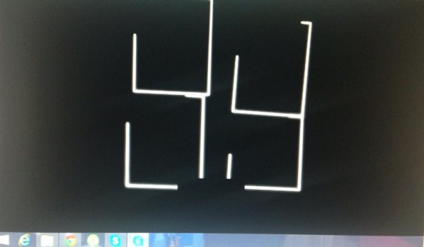

I have a question, when i am mapping on the wall , after a while or after i click on anther layer , windows 8 bar for the open applications start to show under my output screen and its very annoying, why does this happen ?
*A picture of the problem
Thx in advance.
Output screen pop out

Have you tried this: Right click on the Task bar and select Properties. Under Multiple displays, make sure the Show taskbar on all displays check box is not selected.
Re: Output screen pop out
Thanks very much , it worked
