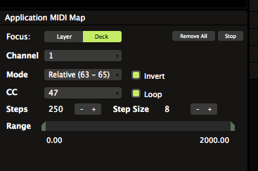

Actually, although most knobs on the APC40 appear endless, they send out regular absolute values in the 1...127 range. Once you twist them past the end or beginning, they just keep sending out 127 or 1, respectively.
The only knob good for scratching is the Cue knob, because this is the only real relative dial.
Once you have it mapped, set its Mode to Relative (63-65) and check Invert. You can then set the step size to however big you want your scratches to be. A step size of 1 means you will scratch 1 frame backwards and forwards with each turn of the knob.
Cue Mapping.png (21.72 KiB) Viewed 11531 times
Keep in mind that this step size is relative to the length of your clip, so the steps will be bigger on longer clips and smaller on shorter ones.
Now I'm off to sit in a corner and giggle about the fact that I wrote 'knob good for scratching' a few sentences ago.

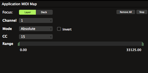

With the following settings:
Screen Shot 2015-11-03 at 12.50.24.png (16.75 KiB) Viewed 11009 times

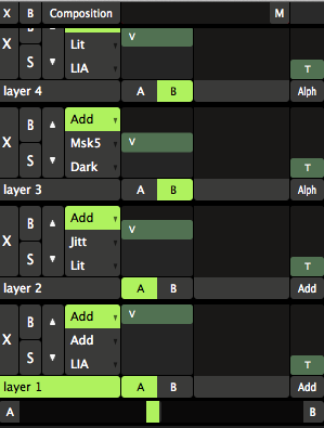

Don't forget that in order to get the A <-> B mixing feature working you will have to select what layers (or layer) is on channel A and what layers is on channel B when VJing
Here I have Layers 1 &amp; 2 assigned to A and Layers 3 &amp; 4 to B
Here I have Layers 1 & 2 assigned to A and Layers 3 & 4 to B
Screen Shot 2015-11-03 at 12.37.22.png (26.13 KiB) Viewed 11009 times
But on the other hand If you want to use the horizontal fader for scratching like I do then you have to assign the fader on your APC to the timeline of selected clip on Resolume
Timeline for selected clip
Screen Shot 2015-11-03 at 12.43.05.png (7 KiB) Viewed 11009 times

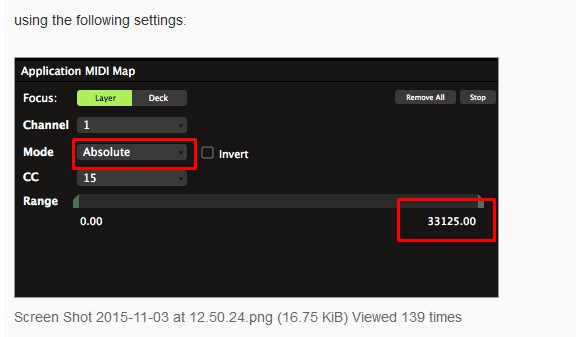

using the following settings:
So now you scratch the selected clip back and forwards very intuitively and once you release the fader the video will resume to its play mode.
