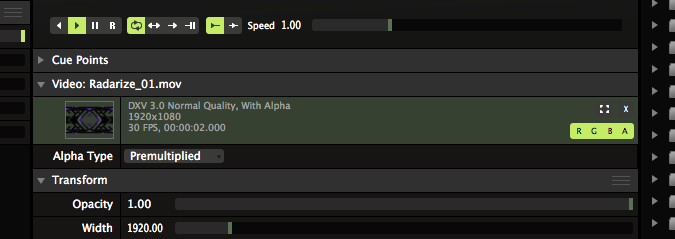

Re: How to tell if Video has DXV codec or not?
Also, don't forget about the clip tab:

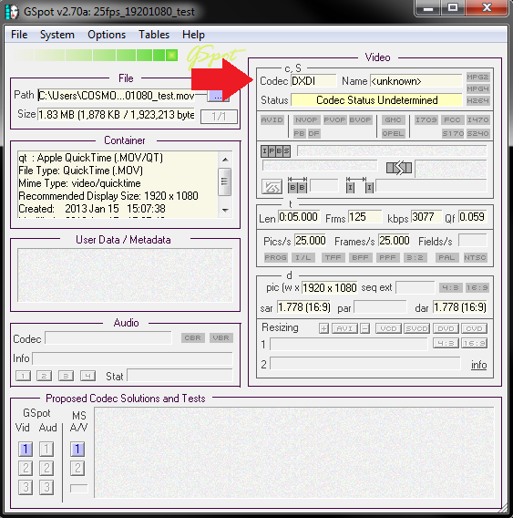

Just to complete this...a bit faster way to identify your clips could be the usage of GSPOT. Its a small video-analyser. Oldy but goldy.
Home of Gspot
You can identify your clips just by drag them into gspot. Codec DXDI is the DXV codec.
