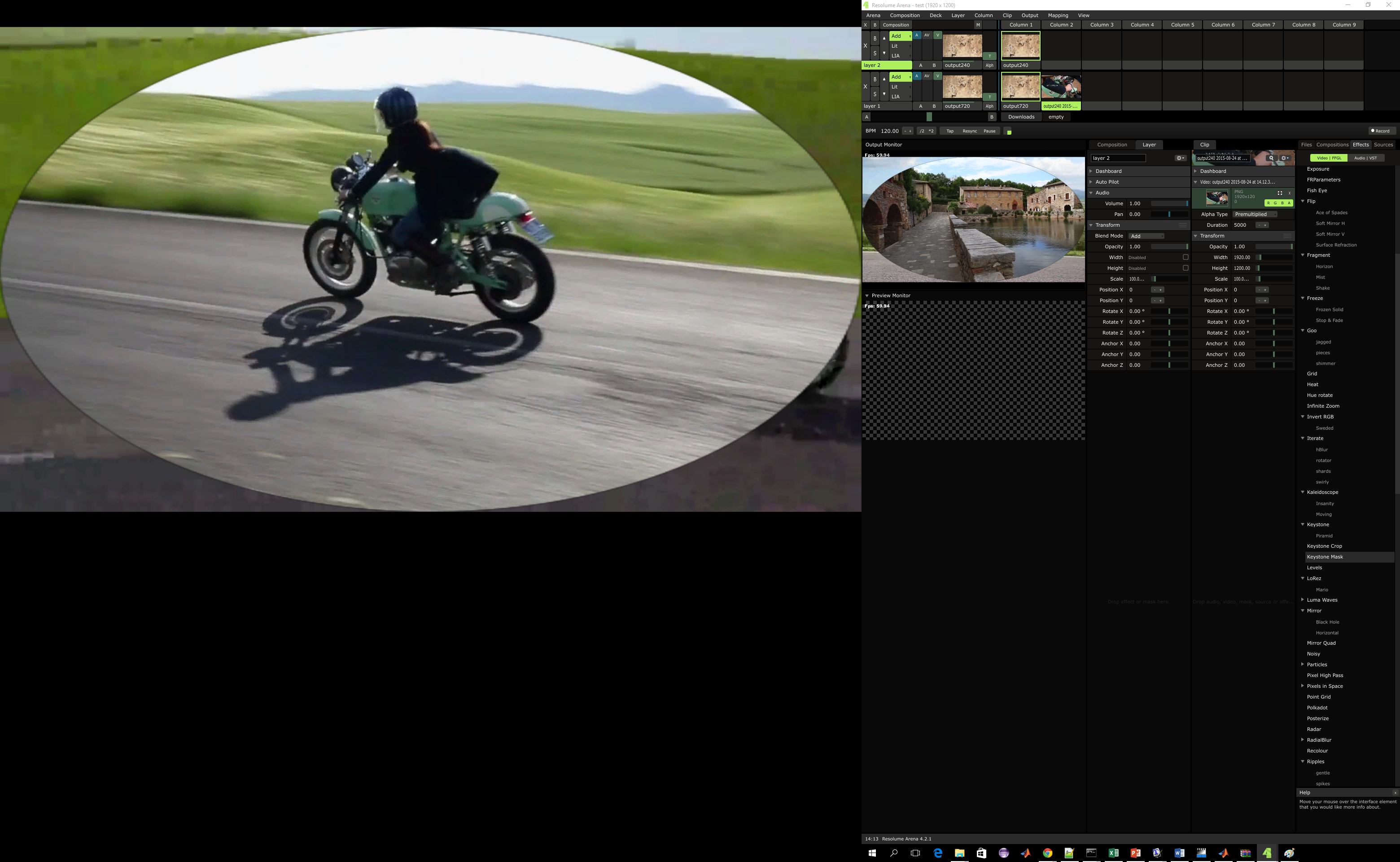

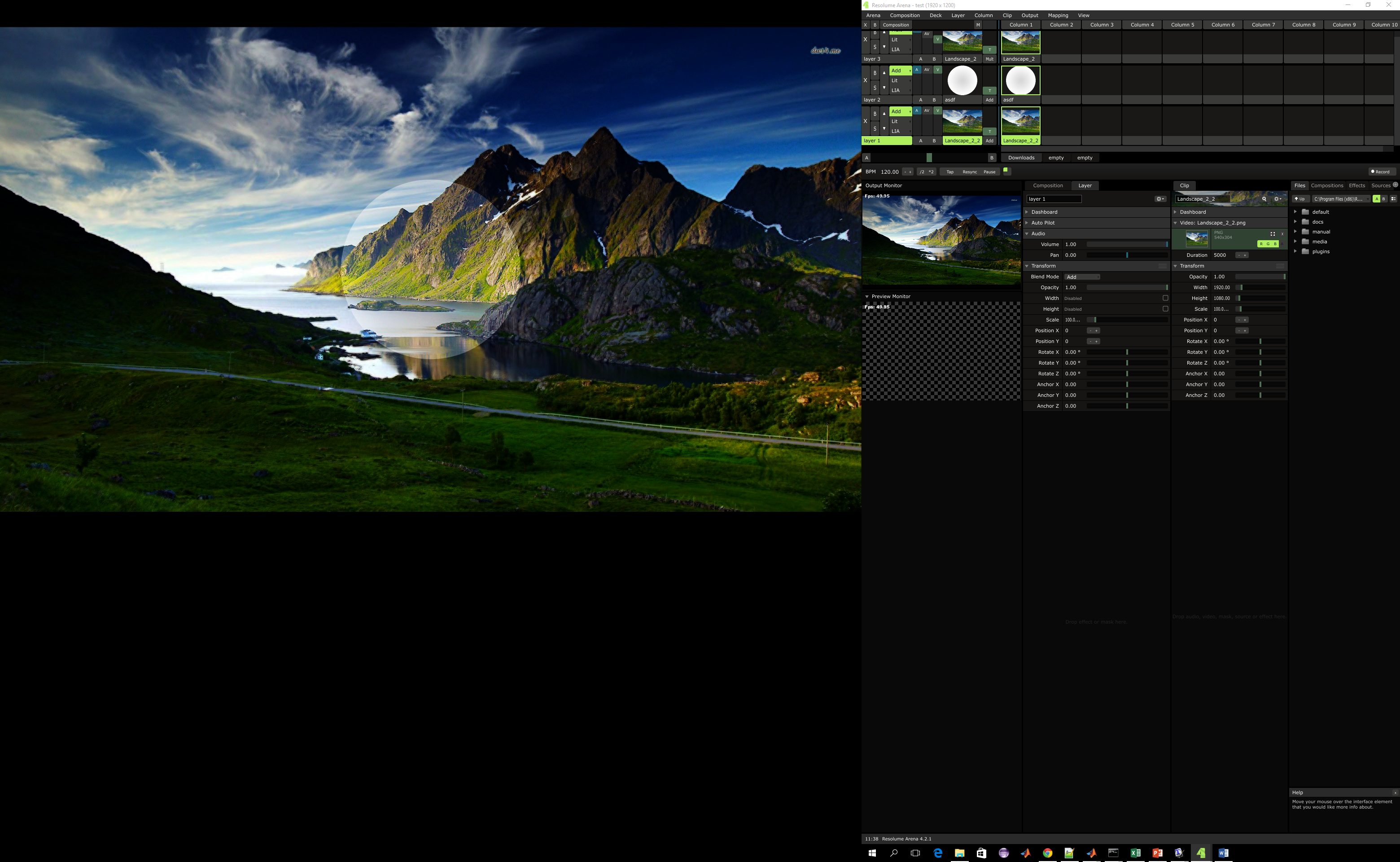

Sorry but I re created the mask but when I move the layer via OSC the whole layer moves. i want only the mask to move and the background and foreground should be adjusted accordingly in real time, which isn't happening.
Posts: 7710
Re: Question for setup
ok, then you can use the osc address /layer2/clip1/video/positionx/values
these addresses are pretty straightforward,
I have to correct myself on the mask, tried it see video for the setup:
