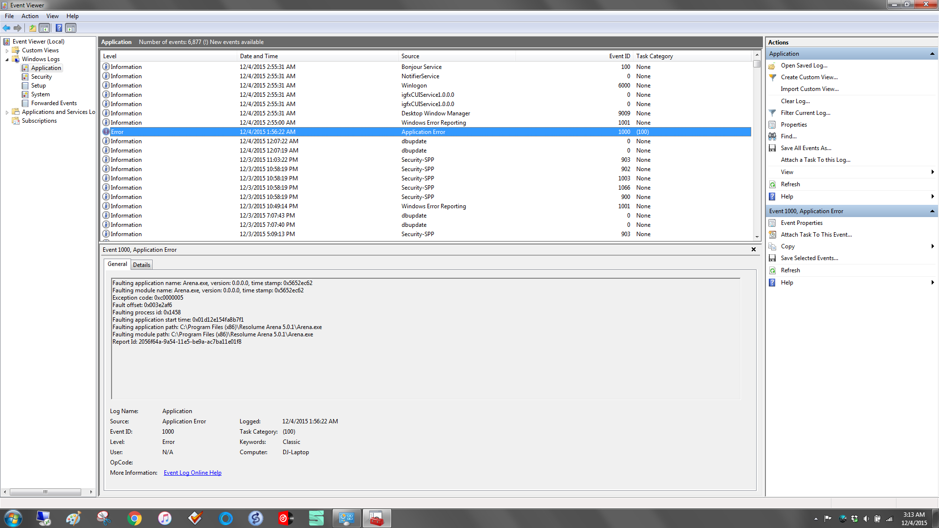

So I am getting some testing done for my NYE set. It was the first time I have run the system all together. I got a crash about 8 hrs in and i have the error log too.
My setup is Win 7 64 bit - Resolume Arena 5.0.1 into Spout 2.0.4 then into Virtual DJ 8.1 b2587 for final display. I don't think it will easily happen, but here are the details:
Faulting application name: Arena.exe, version: 0.0.0.0, time stamp: 0x5652ec62
Faulting module name: Arena.exe, version: 0.0.0.0, time stamp: 0x5652ec62
Exception code: 0xc0000005
Fault offset: 0x003e2af6
Faulting process id: 0x1458
Faulting application start time: 0x01d12e154fa8b7f1
Faulting application path: C:\Program Files (x86)\Resolume Arena 5.0.1\Arena.exe
Faulting module path: C:\Program Files (x86)\Resolume Arena 5.0.1\Arena.exe
Report Id: 2056f64a-9a54-11e5-be9a-ac7ba11e01f8
Faulting package full name: %14
Faulting package-relative application ID: %15
Here is the EVT full view
I clean reinstalled Windows 7 at the beginning of November to clean up. All latest NVIDIA drivers, software etc. I can look a bit later and know computers. Any idea of what else I can provide to research this?
