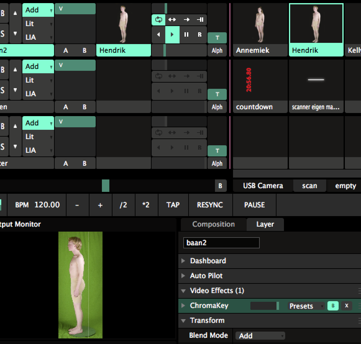

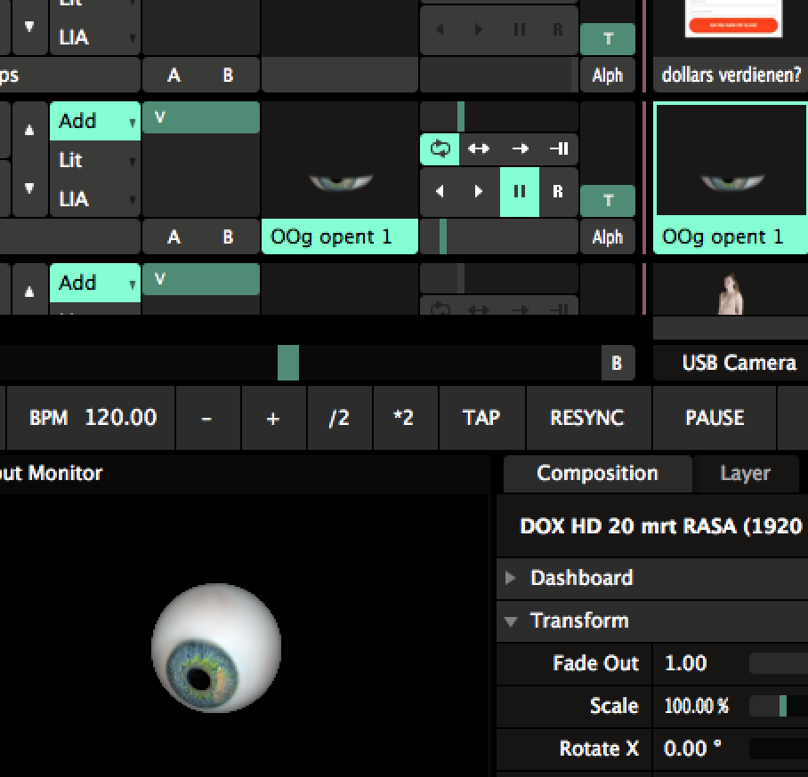

In my exports alpha layers works fine. Same for the thumbnails in resolume (arena 5.02)
But when I load them into my layers, my masks are gone! What should have been transparent is still there...
Even the greenscreen in back in some files :( (those were masked in photoshop, then animated in ae)

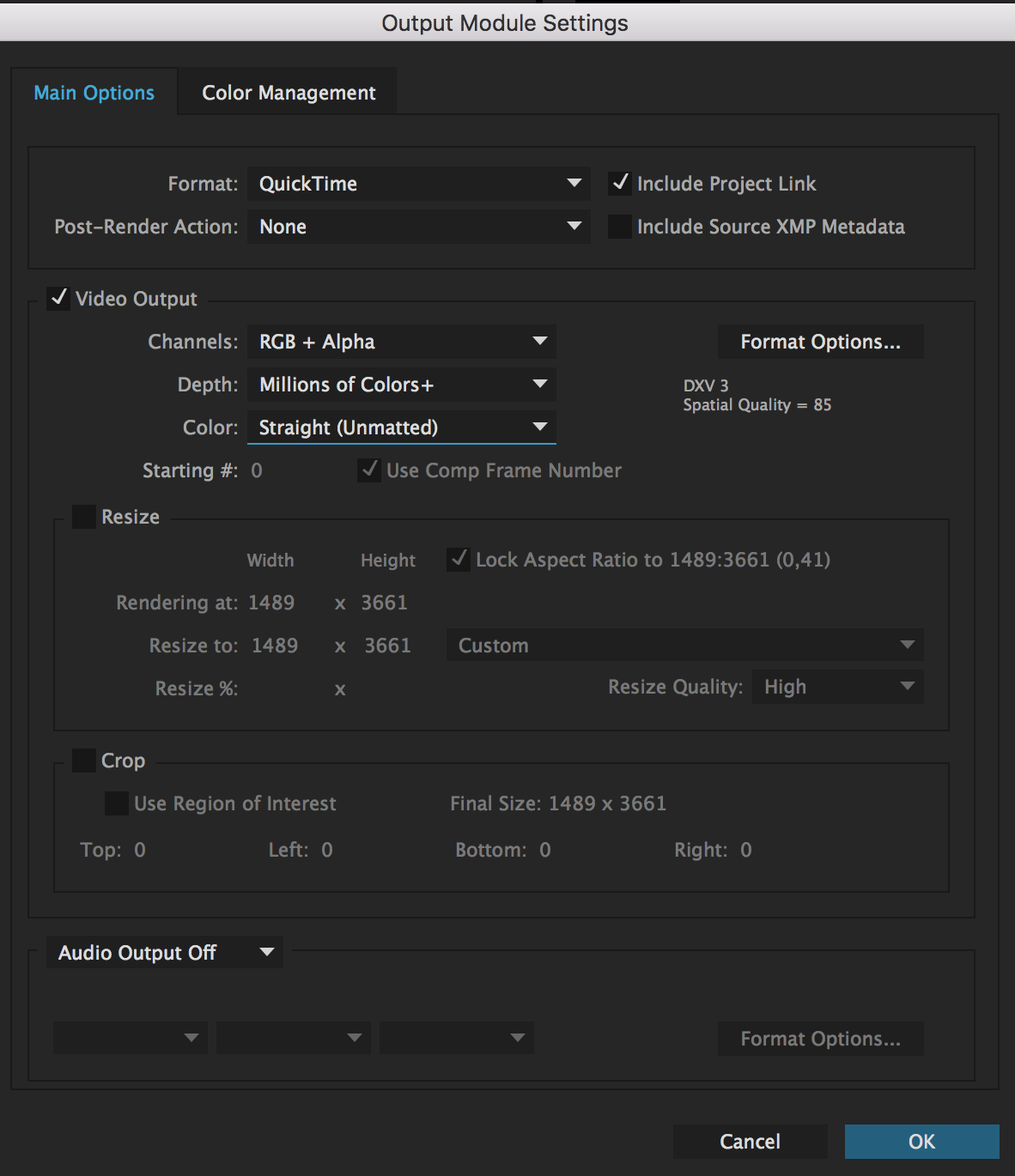

Exported via media encoder (Dxv3, quality 85, alpha straight etc)
Also tried to export a lossless animation & convert that to dxv3, but that makes my alpha layer disappear/become black.
Automask effect in resolume solves the problem, but shouldn't need to do this...?

Hi. Try to set alpha type of clip to "Straight".

Your layer blend mode is set to "add". Try "alpha".
Try exchanging alpha settings "straight" vs. "premultiplied" in your clip parameters.
Re: DXV3 & AE masks bug?
The alpha layer should be the same in alpha or add blend mode.
Make sure you're using the max rendering depth (32-bit) in the video settings when you render DXV with alpha or the alpha channel won't be preserved during the encoding process.

I was outputting straight (see screenshot)
However, premultiplied, to my amazement, seems to have solved the problem.

Before I chroma keyed the layer to remove the greenscreen. That left me without green & some funky white stuff going on. Now, with the premultiplied output settings my greenscreens that shouldn't even be there are now black?!
Automask is not taking the black away even...

in the dxv format options do you have an option with alpha selected ?
Media Encoder:
After Effects:

Yes, thnx for the tutorials.
I have all of those selected.
In finder, all my alpha layers are ok.
Also when I reload them into After effects: no problems
It's just in resolume these things are bugging.....

If Auto Mask is not creating transparency, something is wrong with your blend modes. Make sure everything is set to Alpha and full opacity.
If that doesn't help, can you please post a fullscreen screenshot of your UI so we can see what settings may be causing problems?

@ Asthettic - Here is a link where you can download two DXV3 files with alpha in straight mode to test. One is normal quality and the other high quality and they both work fine as expected on my end
With the Auto Mask effect, if you effect blend mode is set to Alpha make sure the mask opacity is set to 100%.
