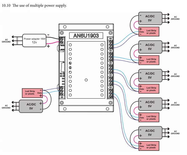

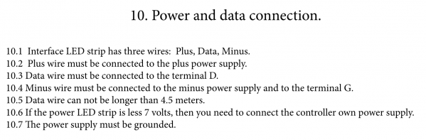

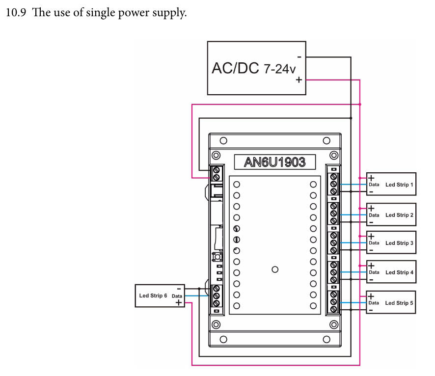

It sounds like you're getting data but no power. The Artnet device you're using doesn't inject power into your strip directly so what kind of power are you injecting into your LED strip?
So, Data and [-] are connected to your Artnet device and [+] and [-] are connected to your power adapter(s) for power
Here is a link to a manual for a similar Artnet converter for further information: http://www.electrondes.com/an6u1903_00/an6u1903_00.pdf

On each port of my device there is a spot to attach Ground (G), Data (D) and Charge (C); I had assumed that since the device is powered by an 5V AC adapter; that power would get to my strips through those channels. You're saying that this isn't the case and that they also need an external power source?
Re: Obscure artnet converter problems
it looks like you need external power supplies but even if you could use that 5Vpower supply to power all your strips you need to make sure that the amperage of the supply is enough to cover everything you're powering.
To put things in perspective, typical RGB 60/M 5V tape will require anywhere between 12 & 18 watts per meter so if you had 170 RGB pixels (max per universe), you'd be looking at roughly 3M of tape which would be 36W to 54W or 4A to 10.8A which is why your controller is likely to require external power supplies to power the 6 strips.

Hm, thank you. It's a 1 meter 5V strip; the settings in Resolume were just a bit of test in that regard.
Since you're using only 1M, a 4A 5V power supply should do the trick whether you're using 30/M or 60/M RGB strip.
