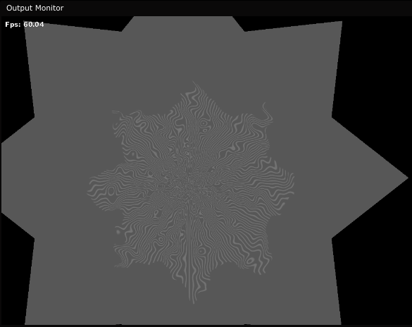

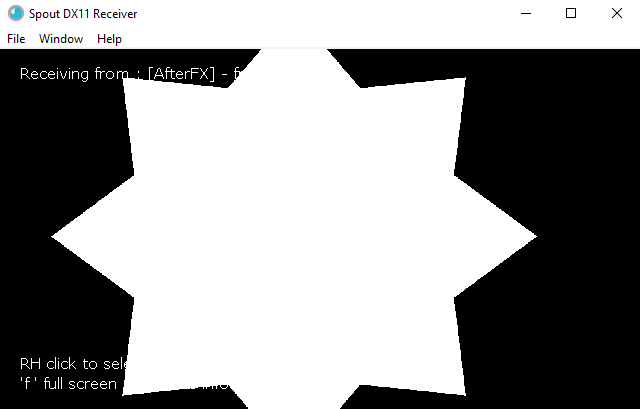

The output shown in AE is not the same than in Resolume and I'm wondering if there is a workaround for this. Also Spout receiver using the "wrong" content.

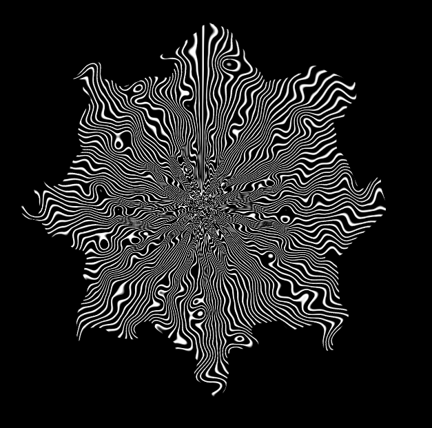

Star in AE using "Polar coordinates",  "turbulent distortion" and inverted "polar coordinates"
Star in Spout viewer
In Resolume I can switch between both versions in this example:

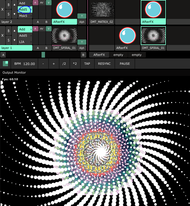

--> Blend mode "Add" shows the spout star and with "Add50" I can see the actual star as shown in AE
(this was not working with an older Version of Spout using the lowest layer "Layer 1")

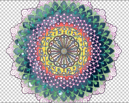

IN AE I want to create an overlay of an clip and a cutted mandala picture with some transparent areas. The idea is to see the video only in the transparent part of the image. Again there is adifference in the output of AE and Spout which can be switched via selection of Add and Add50.
Cutted mandala with video in the middle and transparency outside

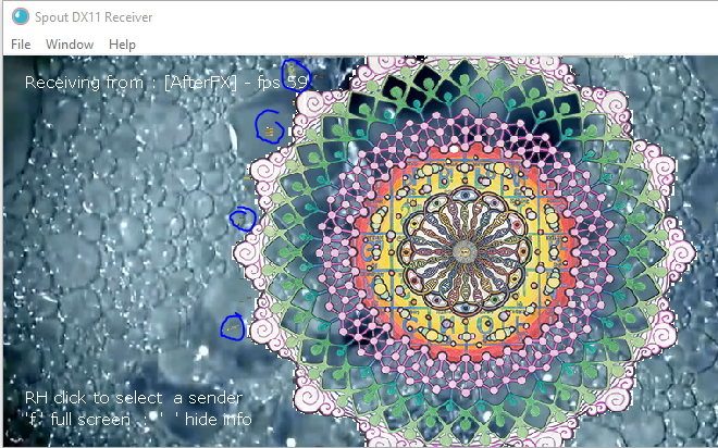

Spout output of mandala but with the video outside the mandala and pixel errors
Please note the pixel errors on the left side which are not visible in AE or Photoshop. In Resolume they are visible using Add but not with Add50.

Re: After Effects and Spout: Resolume shows different content
I think your issue comes from the way your AE mattes are interpreted in resolume. Take a look at this post which may help you.
Posts: 7710

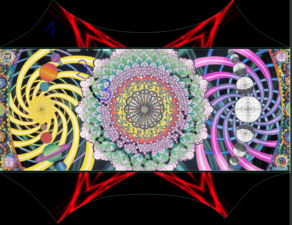

if you're trying to achieve the look shown in your 4th picture in resolume, then switch the mandala layer to alpha blend.
add50 at 100% opacity behaves like an add with 50%.
The difference between your textures comes likely from the wrong alpha setting in the spout clip as Oaktown suggested.

But, great, for the moment I'm happy to have this 3 videos separated with the right overlay of the 2 pictures:
Is it really needed to stamp the top video (mandala) with after effects or is it also possible with Resolume directly? This will save the AE channel for other ideas.
this makes sense, but for me it seams that with AR/spout it is a bit "more". In add mode the star from my 1st example is much bigger in add mode compared to add50. If I reduce the opacity in add mode to 30% you can clearly see the difference scale.
Maybe one additional question. Is it possible to switch the spout channel to the same view I got in Resolume with the Alpha type "straigt"? Spout has still the big star without lines.
