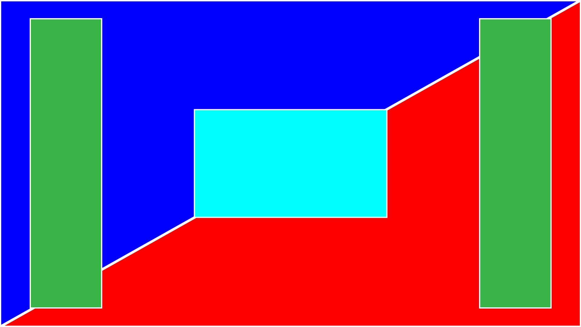

I would start by eliminating the layer to slice routing from your setup.
Instead, I would create an input map that resembles your stage setup. It's difficult to make an example based on your particular setup, because you don't mention what the actual output should look like. Based on your description, I would assume something like this:
Blue + Red = Background + Text & FX, both covering everything
Cyan = Center Screen, just in the middle of the comp.
Green = Side Only, just on the sides of the comp
Using the composition as a tool for compositing this output (what's in a name, right?), you can easily create four layers that will only show content in the designated areas. At that point, all effects you apply on the composition, will be applied on the composition. And it becomes a lot easier to add more layers to the setup, plus you get more creative freedom because you can position additional layers freely in the comp.
Does that make a bit of sense?

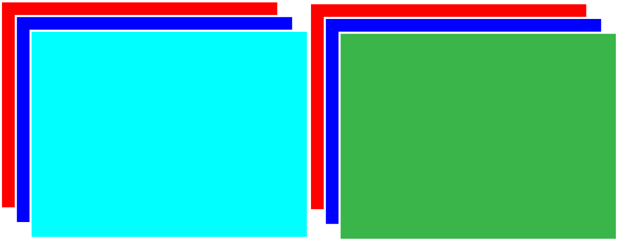

Re: Having headache for global effects, layer routing, advanced output.
Reading your post again, I think there also might be a chance your output needs to look like this: with left and right both having the Red and Blue layers, and Cyan on the left and Green on the Right.
The same principle applies. In this case you would create a composition twice as wide, and would have a layer with content positioned on the left, with a Slide effect applied at 99.99 opacity to put a copy of it on the right side.
Yeah, in that case, you want the dual wide comp setup.
Remember to swap the rendering order of your transforms and effects if you want to use the Slide trick.
