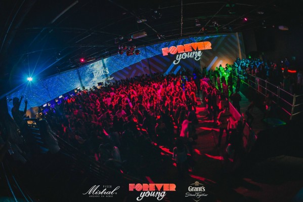

Hi
coincidently I'm using a very very similar setup!
I'm using two TripleHead2Go Digital SE (Display Port - 3x 1280x800) connected to 6 Epson projectors via DVI-HDMI passive cable adapters and then to each HDBaseT extender.
I'm not having any issue using Hackintosh with my GTX960, the only weird thing is sometimes projectors change its order and you have to remap or simply switch the HDMI-HDbaseT cable to have your original order and avoid remap.
Windows is a different story, I'm having problems with the Matrox GXM Software, sometimes it doesn't recognize one matrox or it loops flickering the screens trying to load the setup and you have to reconnect - restart PC. You need to have everything ON and as a last step turn on your computer to avoid any weird issue.
My resolume composition is 7680x800 working with DXV3 using 3-4 layers and still throwing >35 FPS
Sorry about my english
Feel free to ask anything, happy to help.
Here's a Pic!

I talked to matrox and they told me it will work with the SE.
