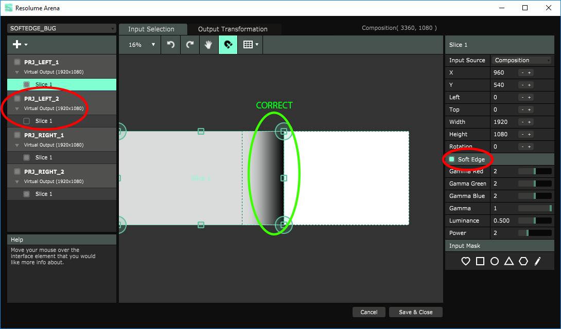

When the secondary (stacked) projectors outputs are turned off the soft edge is correct and you can see the gradient on the central part of the screen.

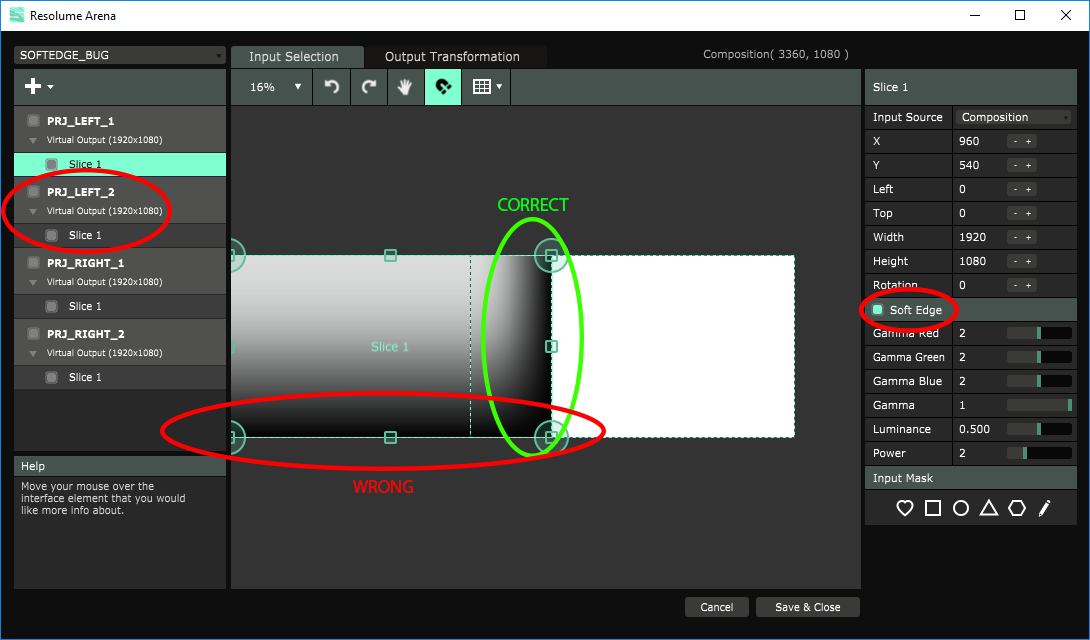

When turning on also the "stack" projectors the central part remains correct but the bottom or the top part of the slice also shows a gradient and that is not correct. This happens when 2 slices of 2 different projectors overlap perfectly. In this way when all 4 projectors are turned on there will be a gradient fading to black on the lower part of the projection area.
I attached some screenshots to show the problem.

Wrong soft edge with stack projectors turned on
Correct soft edge using only 2 projectors

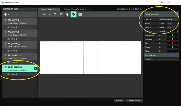

For future reference on this topic here it is a short explanation with screenshots:

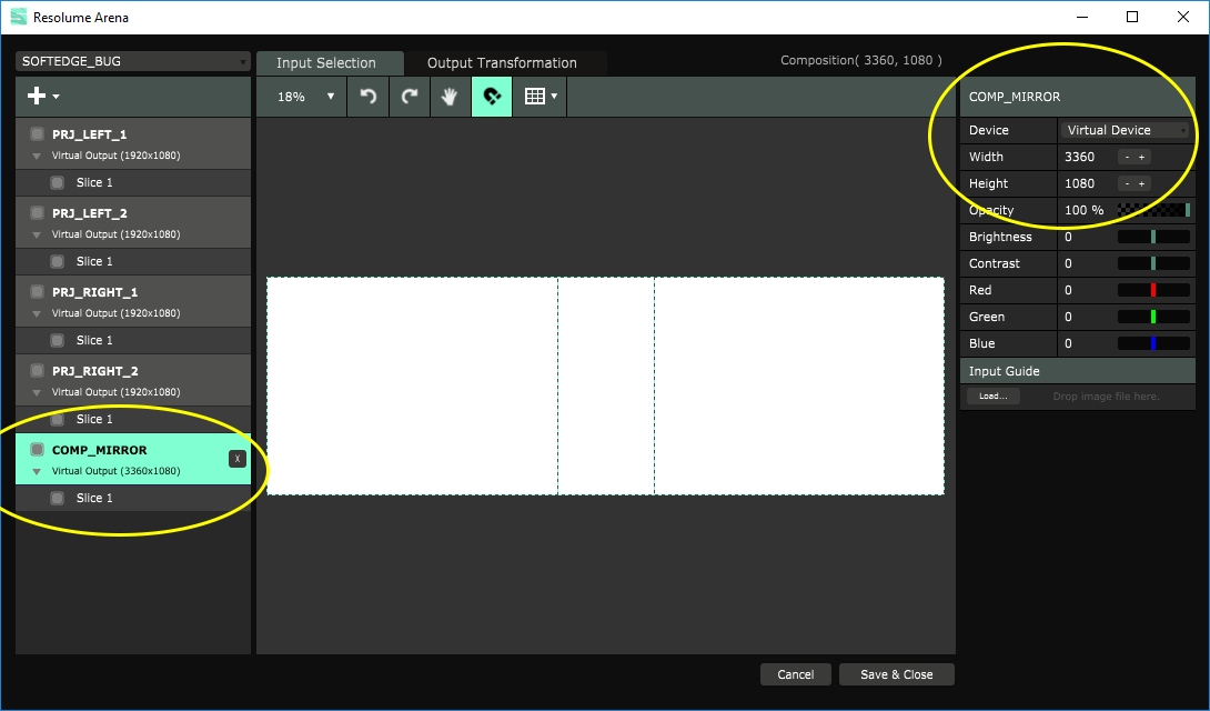

- Create your composition (for example 3360x1080 px)
- Set up a virtual output with the exact size of your composition and call it "COMP_MIRROR"

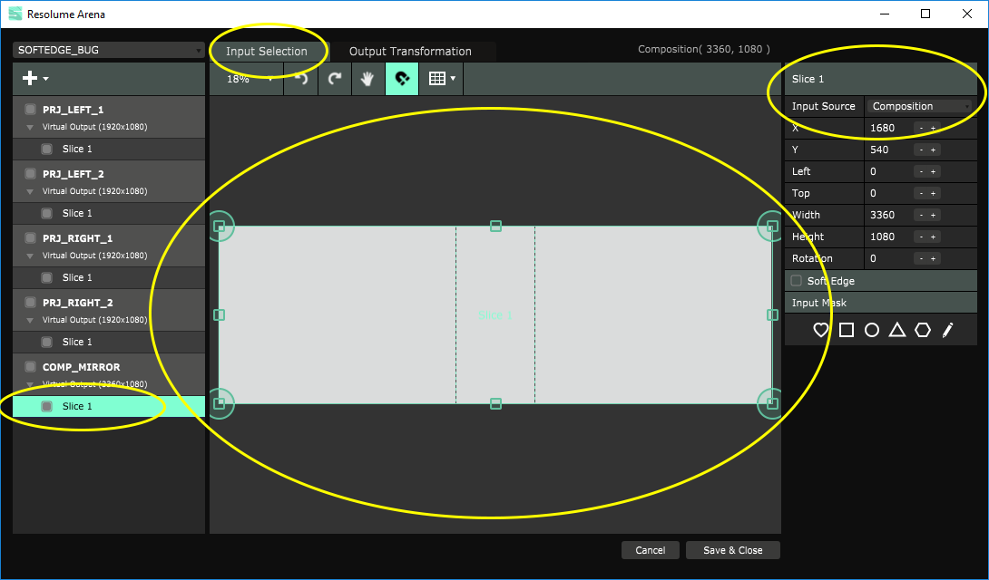

- In COMP_MIRROR create only one slice taking the whole composition area and "Composition" as input source

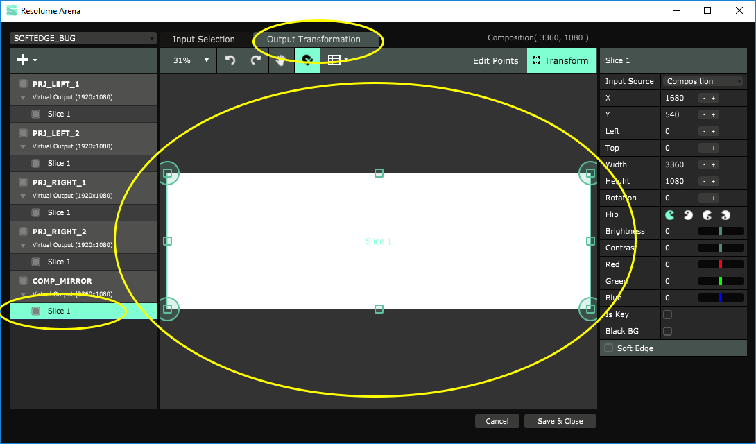

- Check that the output transformation covers the whole area

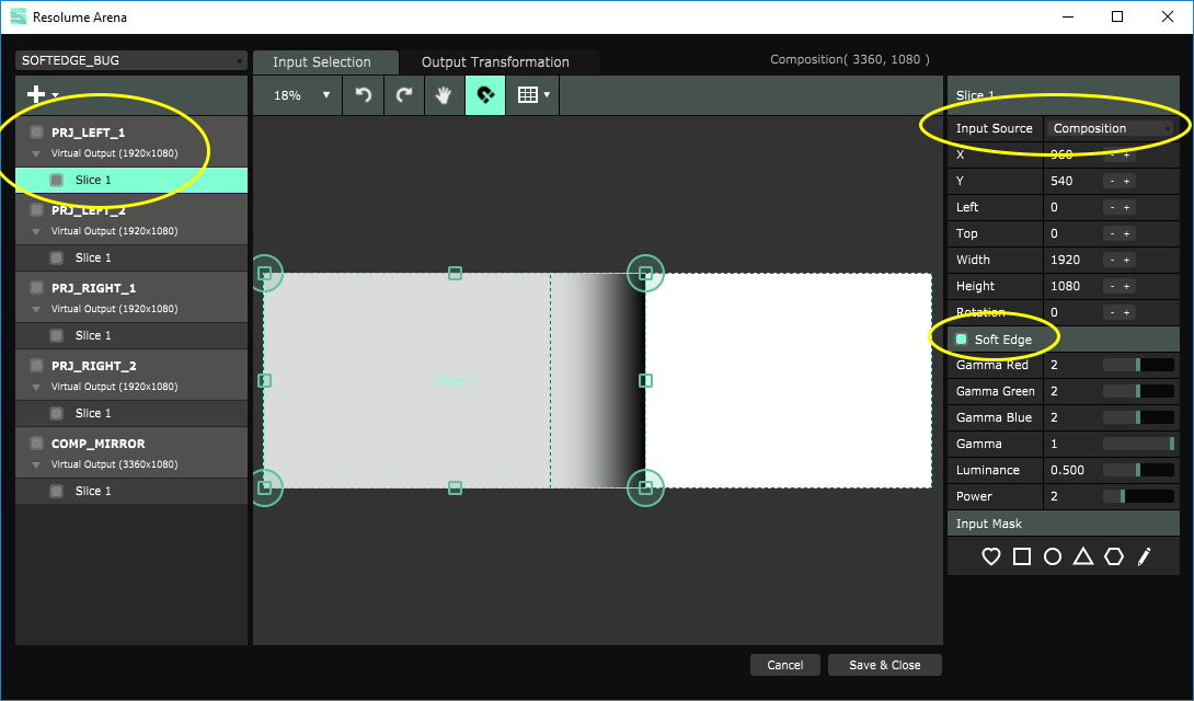

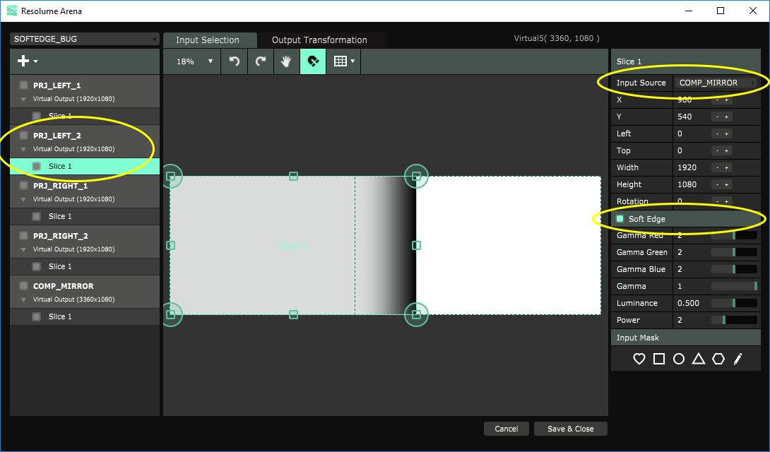

- set up the first projector of the "left stack", with only one slice and "composition" as input source. Don't forget to turn on "Soft Edge" checkbox
- set up the second projector of the "left stack", with only one slice and "COMP_MIRROR" as input source. Turn on Soft Edge
- Do the same with the right part of the stack
- Assign outputs to your phisical projectors
- Use "Ouput Transformation" to get the stack (and soft edge) perfectly aligned
Alberto
