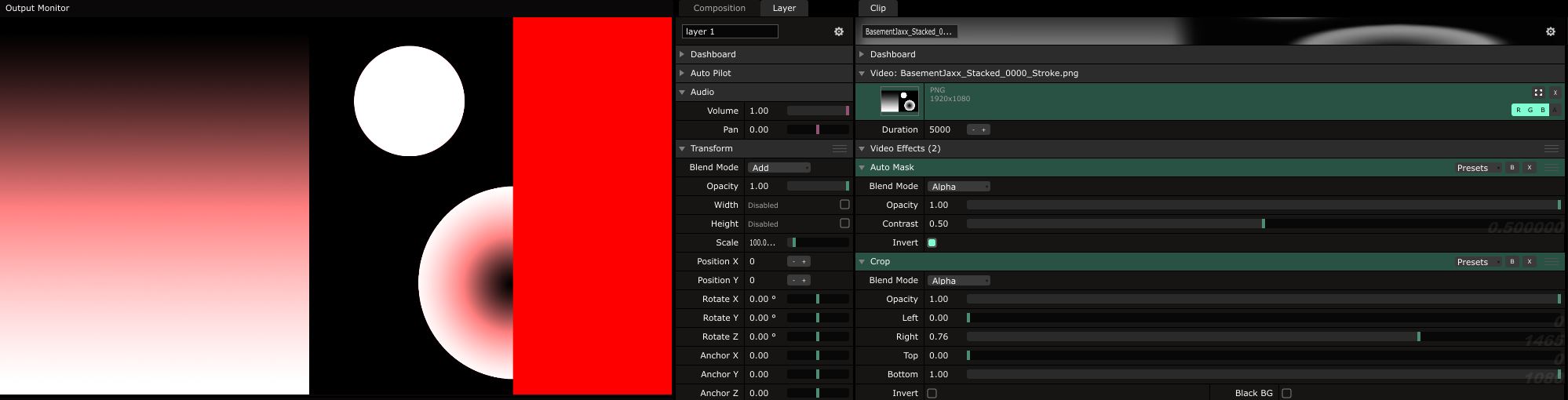

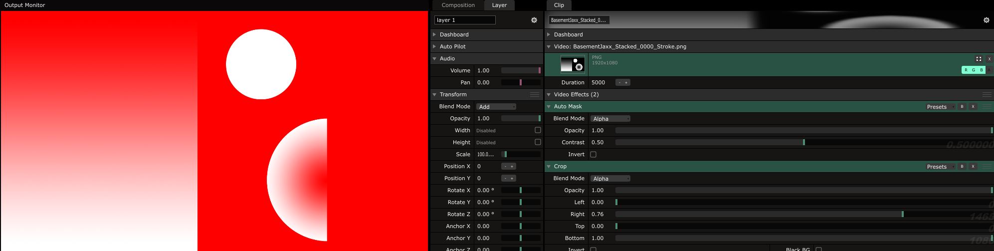

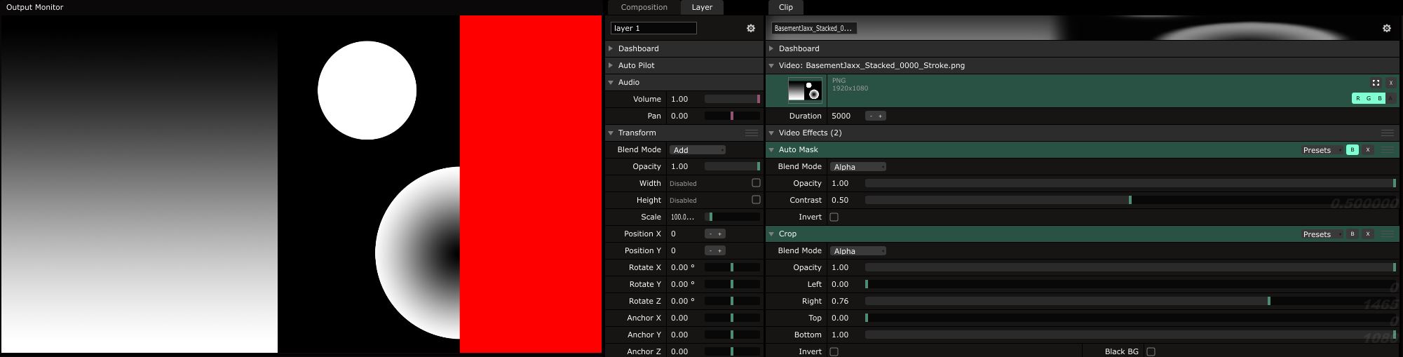

I would assume the invert function of the Auto Mask Effect would invert the effect, knocking the white out instead of the black?
No Mask
Auto Mask
Invert Mask
