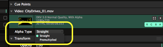

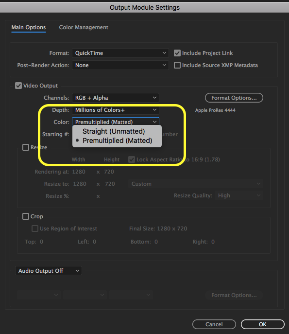

Looks like you're rendering with a straight alpha channel from AE, and telling Resolume to interpret it as premultiplied.
Either switch the alpha channel to straight in Resolume, or render premult out of AE.
