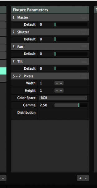

I'm sorry, I don't understand how the spacer behaves differently from a dummy parameter that can be created in the Fixture Editor?
You can create these channels in the fixture, give them a default value, and they will become part of the fixture and be taken into account when patching.

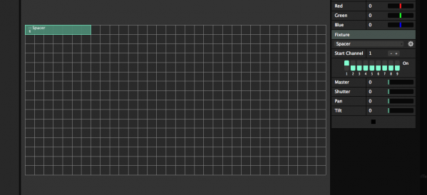

- Posts: 8
- Joined: Wed Feb 15, 2017 14:27
- Location: London
Re: Fixture building with partial control
I agree, it should work like that, but for some reason every time I launch the software, I have to go into the editor and slide from zero to full and back, otherwise it outputs 100% on these channels.
If I clear my programmer on my console, then monitor incoming artnet, start Arena, I see everything but the colour parameters jump to 255. Once I do the above, it all zeros and behaves as it should.

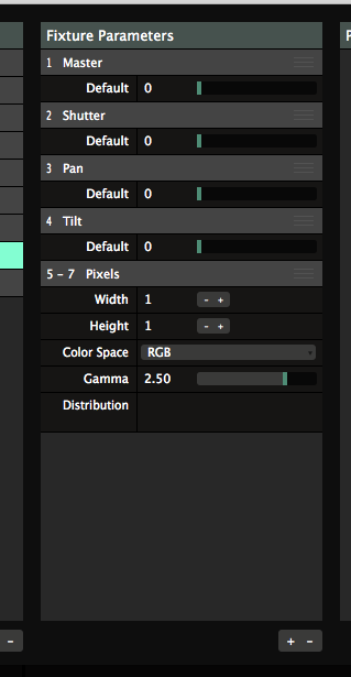

And is the default value for this channel set to 0 in the Fixture Creator?
We just did a quick test with this:
- we created a new fixture profile.
- the fixture consists of 2 dummy parameters + 1 RGB block.
- the first channel has its default set to 255, the other set to 0 (note this is the Default value slider in the Fixture Creator, not the slider that is available when patching the fixture!)
- we set up this fixture in a Lumiverse, patched to channel 1
- we saved the setup
- we set up to output the Lumiverse via Art-Net
On both Mac and PC, after restarting Resolume, it will send the default values for the dummy parameters: 255 for the first one, 0 for the second one.
This is the expected behaviour, and how it should work. If you are experiencing it differently, could you let us know how we can create that behaviour?
