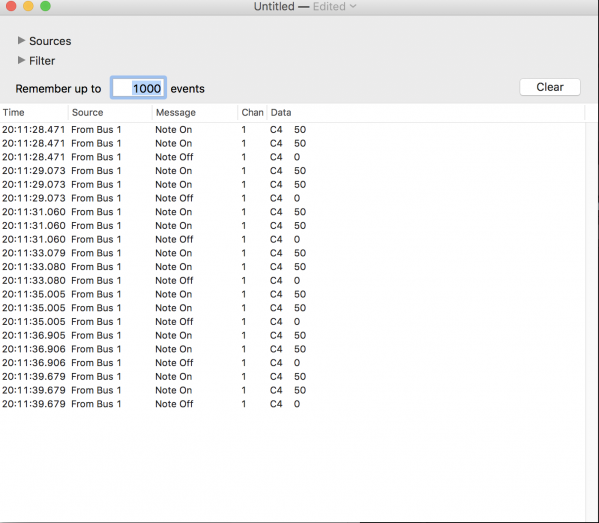

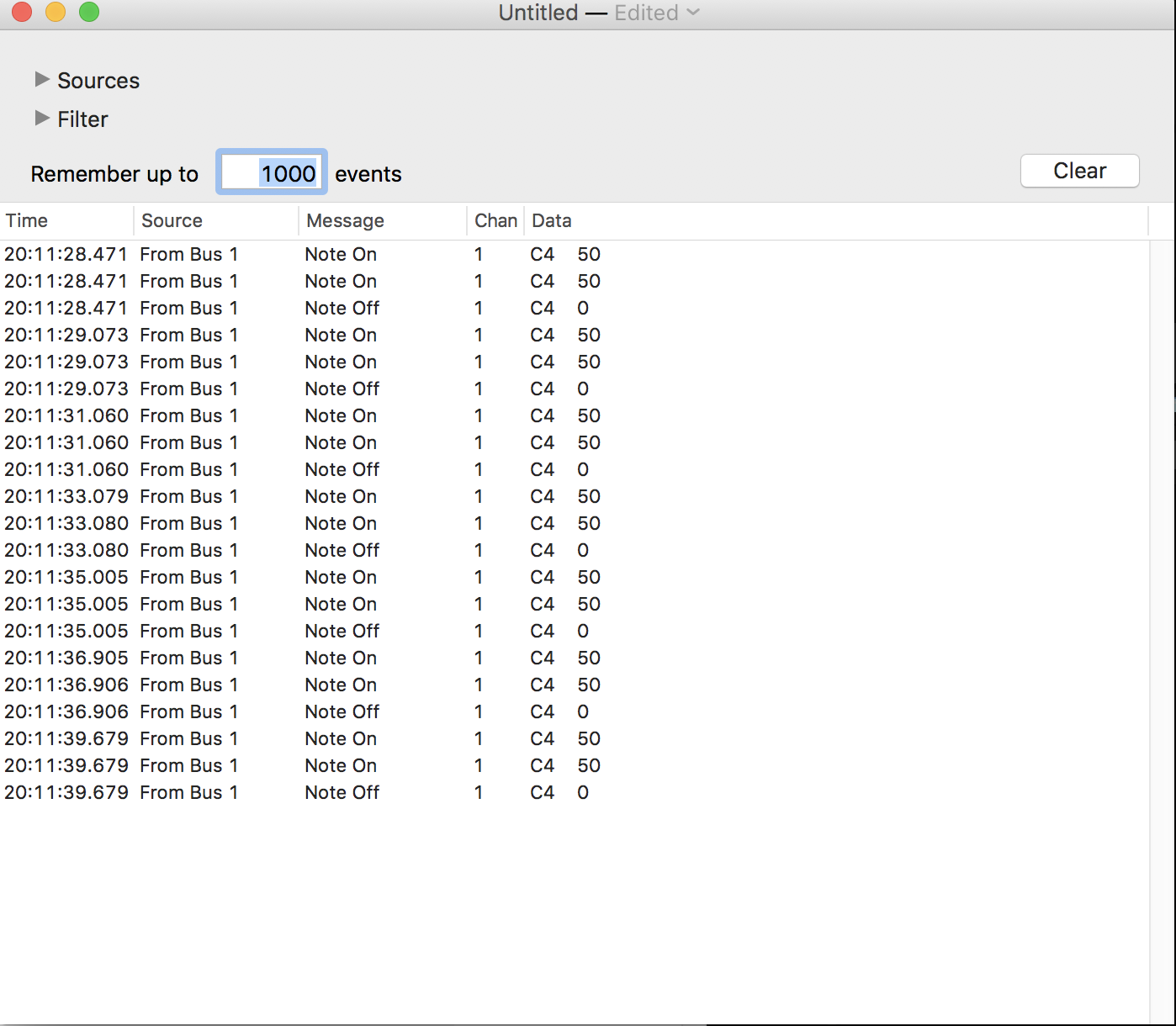

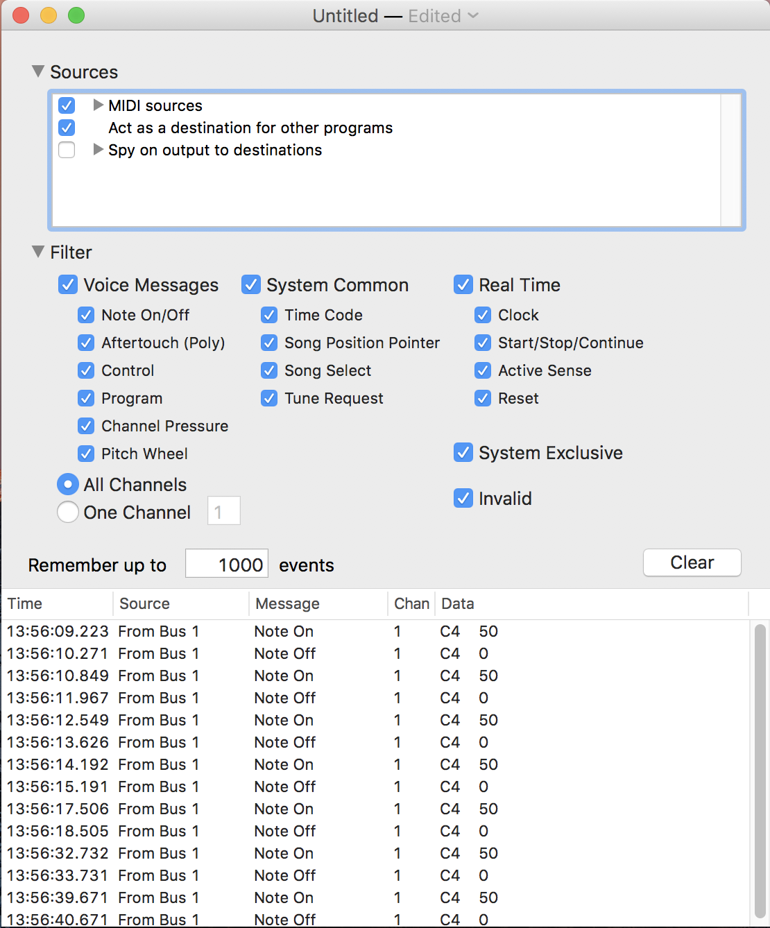

The first thing that I would do is use Midi Monitor to see what data is actually being sent by the Arduino.
So I downloaded Midi Monitor and this is what I got:
Midi Monitor
Midi Monitor
Any Ideas?

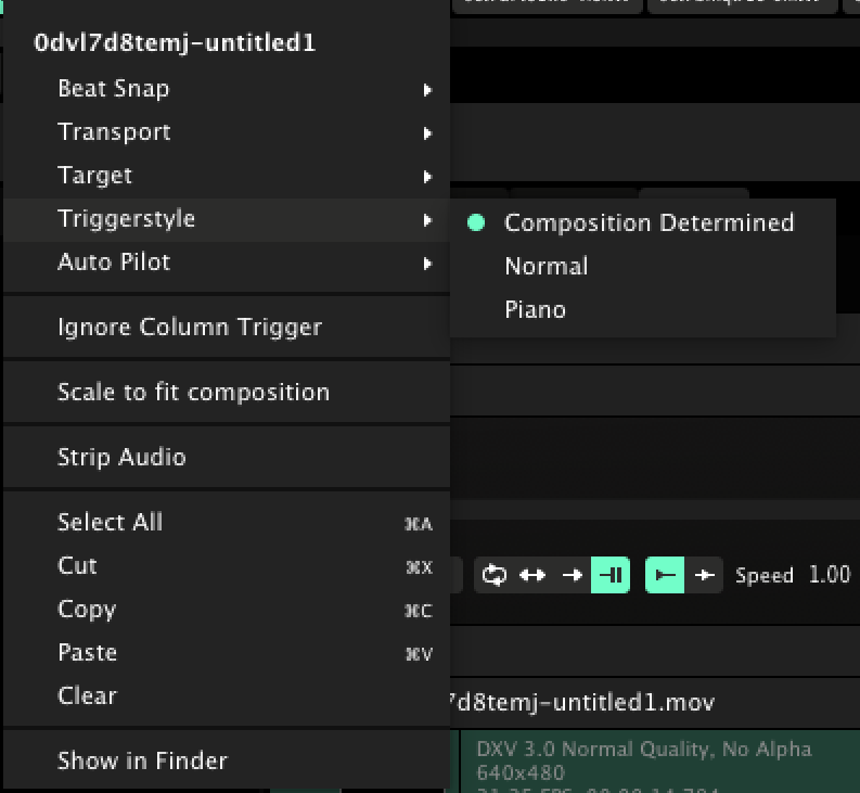

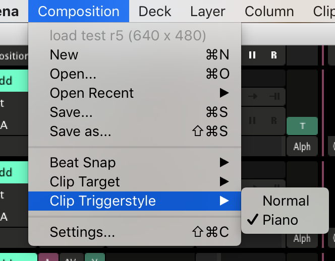

Check composition and clip trigger style, in piano mode your clips will stop if they receive a note-off.
clip right click menu:
blabberbytes
Posts: 36
Joined: Tue Jul 05, 2016 23:50
Re: Arduinio Heart Rate Midi
Post by blabberbytes »
Thanks, this is actually helpful for midi attributes with sliders such as opacity and what not. But for launching clips the same thing happens, it just freezes and video doesn't launch. I've tried setting different delays, I was thinking maybe resolume was receiving too much data? Thoughts?

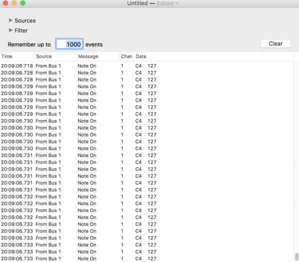

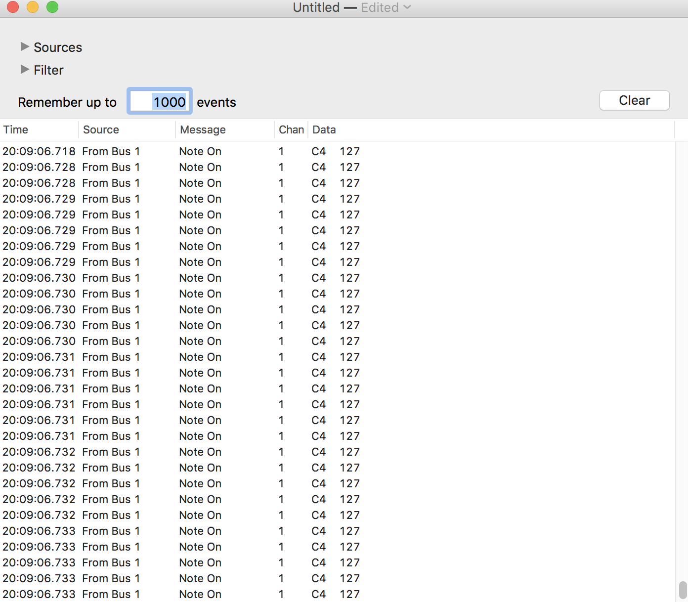

So I removed NoteOFF and video does not play. I am using Midi Monitor and noticed when I map it to the clip, it starts to constantly send a signal. When I map it the R button (channel that turns red on/off) the button switching back and for that the rate of my heart but in Midi monitor it seems to be turning on/off at the same time. I attached to images of the two scenarios:
clip launch
clip launch
R Button
R Button
Why don't you use a MIDI CC and send values of 0 & 100 instead of a MIDI note on or off?
Edit: I meant to say values of 0 & 127
How would I go about doing CC instead of midi NoteON/OFF?? I've been looking and trying things to no avail. Thanks everyone.
Holy crap dude, you're sending around 500 midi messages per second. Do you also have output to the IAC bus enabled in Resolume or something?
