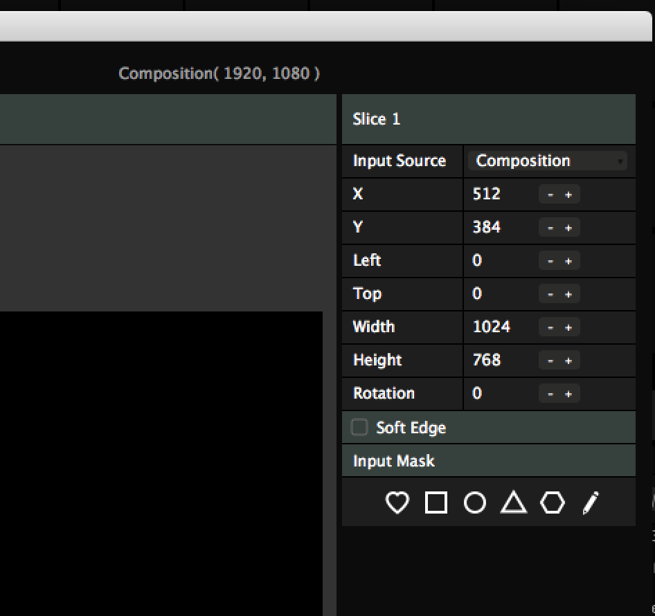

Re: Fusion problem , no fusion in my output
I guess you have the slices in advanded outuput, slice input set to Layers, and slice 1 is probably layer 1 slice 2 from layer 2 and so on.
Check your input slices, on the right side you'll find a Input source dropdown, select Composition.
You don't need more slices than one if you are outputting from composition mix only.
