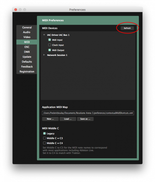

And thanks for the reply Oaktown, that definitely refreshes the available devices seen by Resolume, but in my case that button does not also re-establish the connection with your MIDI as input an device (it'd be great if it did though, that "refresh" button was the first thing I tried)
