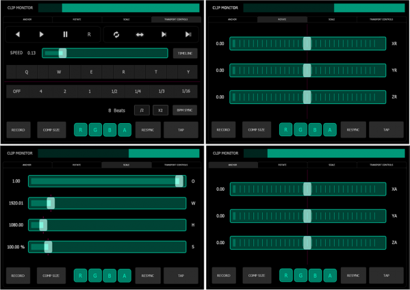

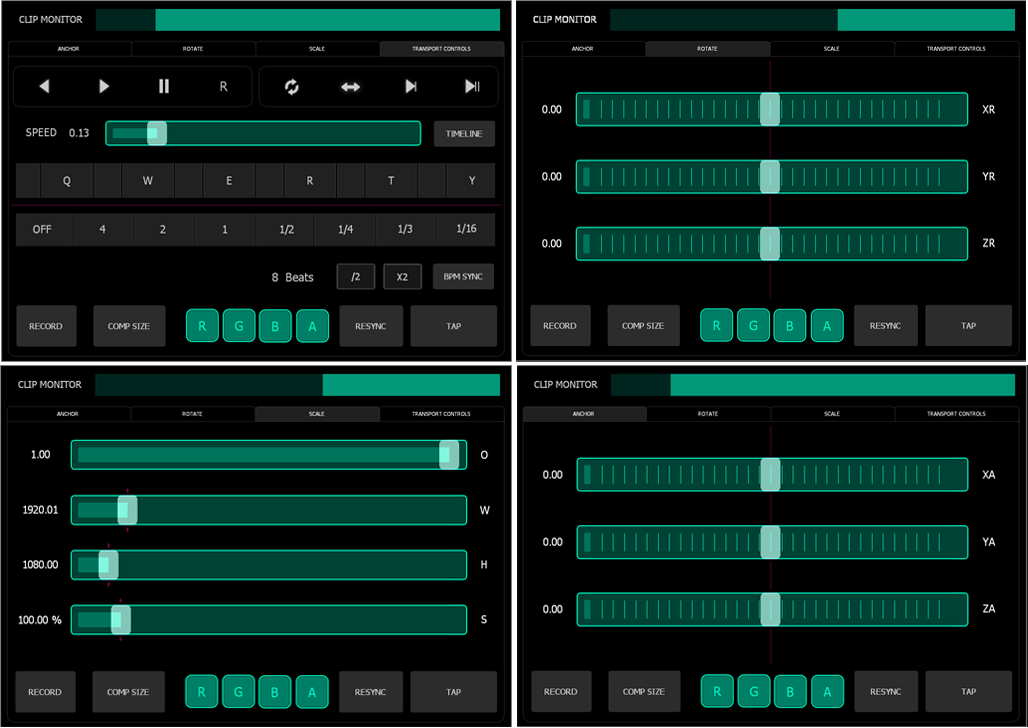

Compiled code from the user library at liine.net to add quick access to clip parameters using an iPad with Lemur. Needs some work with the cue point section - not updating the toggle on/off indicators. Arena 5 is working, I tested with Arena 6 Beta and have not been able to connect. If you can find a solution, please upload it. Thanks!

Post by jotrujil »
