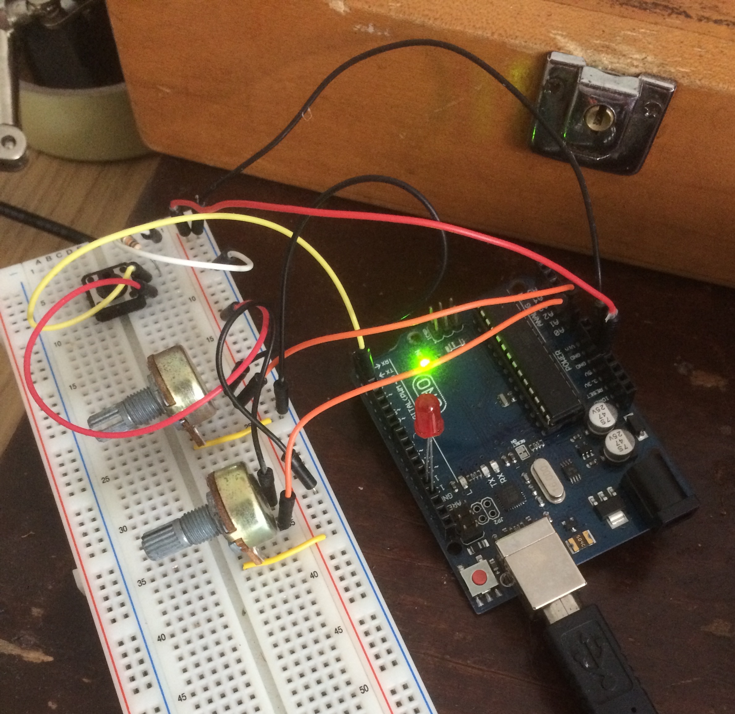

At first I had used and Arduino Uno, alongside LoopMidi and the Hairless-Midi tools for the proof of concept and it all was fine:
That was all perfect, as I was able to map Resolume correctly and it would 'hear' the command properly.

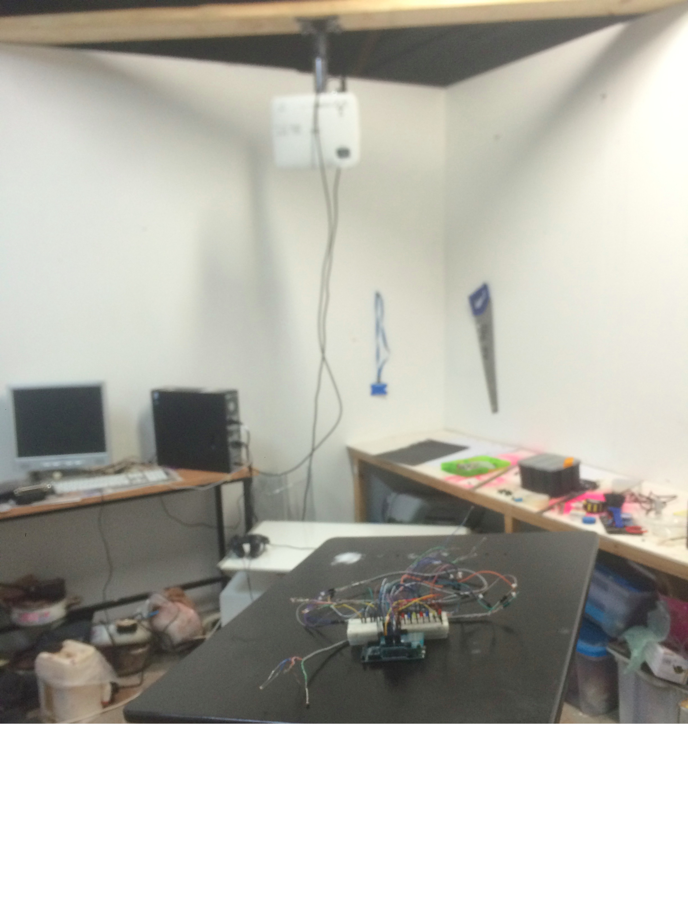

The next phase was to move things up to the Arduino Due, as we wanted to be able to have more permutations of pages of the book {jumping from 3 sensors in the first test up to 6}. At this point in the work, everything functioned perfectly again, so I had 4 slices {top left, bottom left, top right, bottom right} each with a layer mapped to it, then one midi note to cover changing the 4 slices as each page turned.

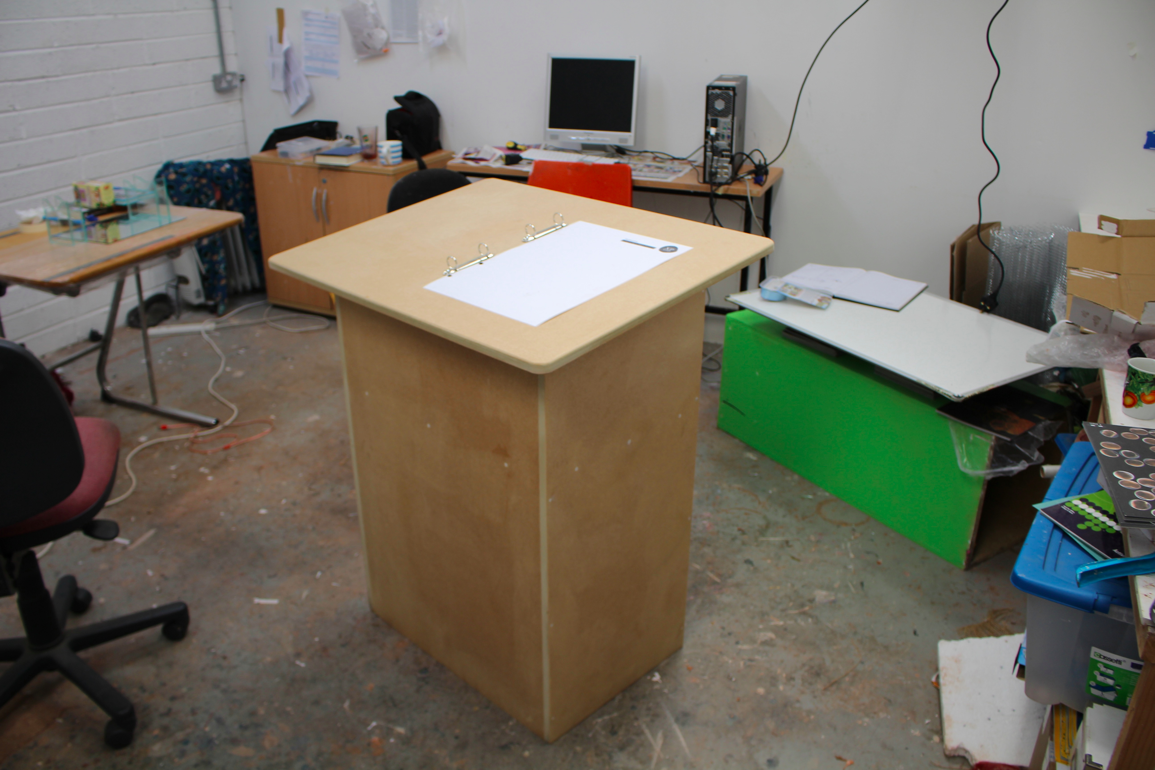

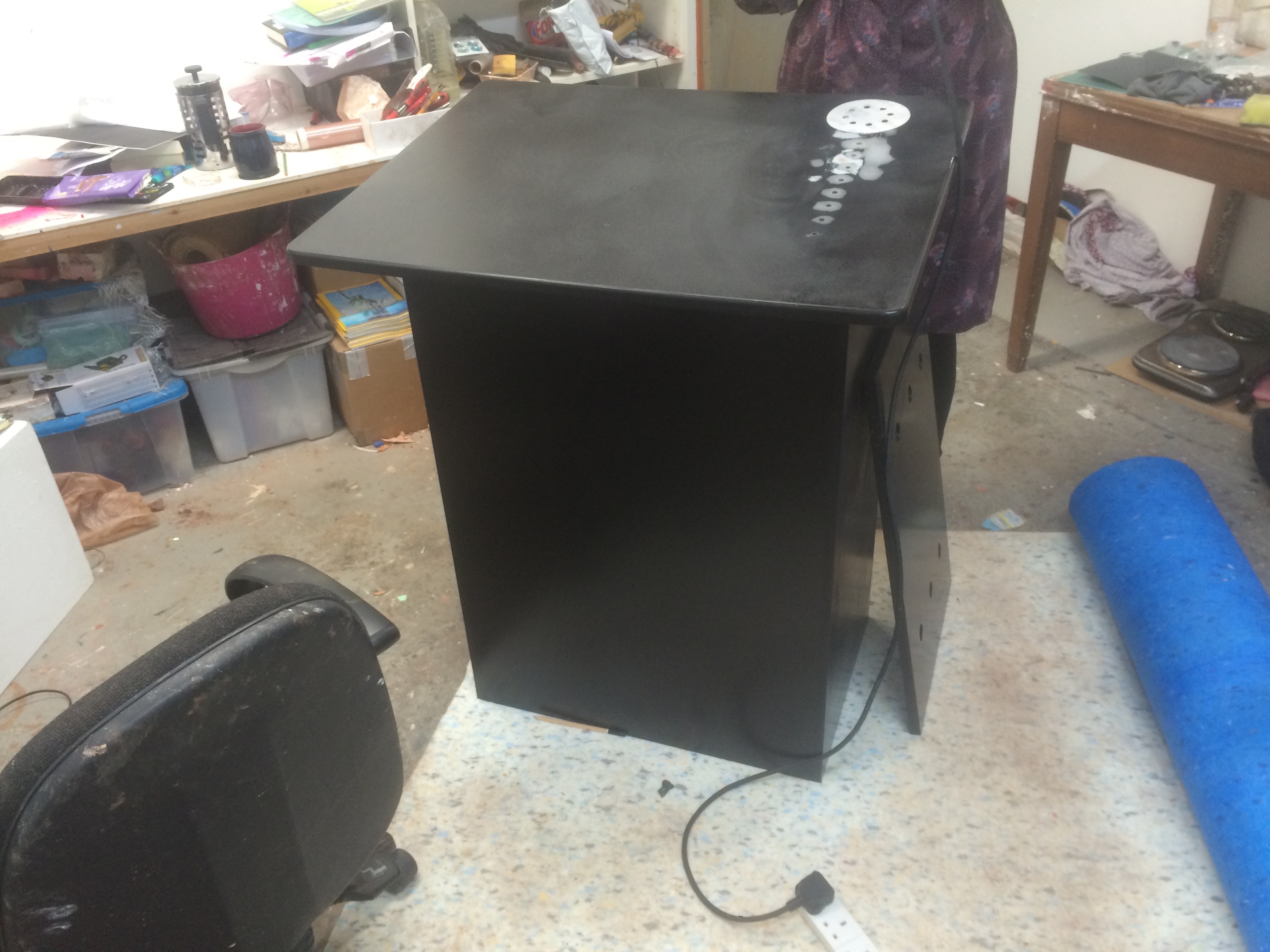

At this point, as everything was cool with the hardware and code, the focus went to the presentation of the plinth, and how the sensors could be concealed:

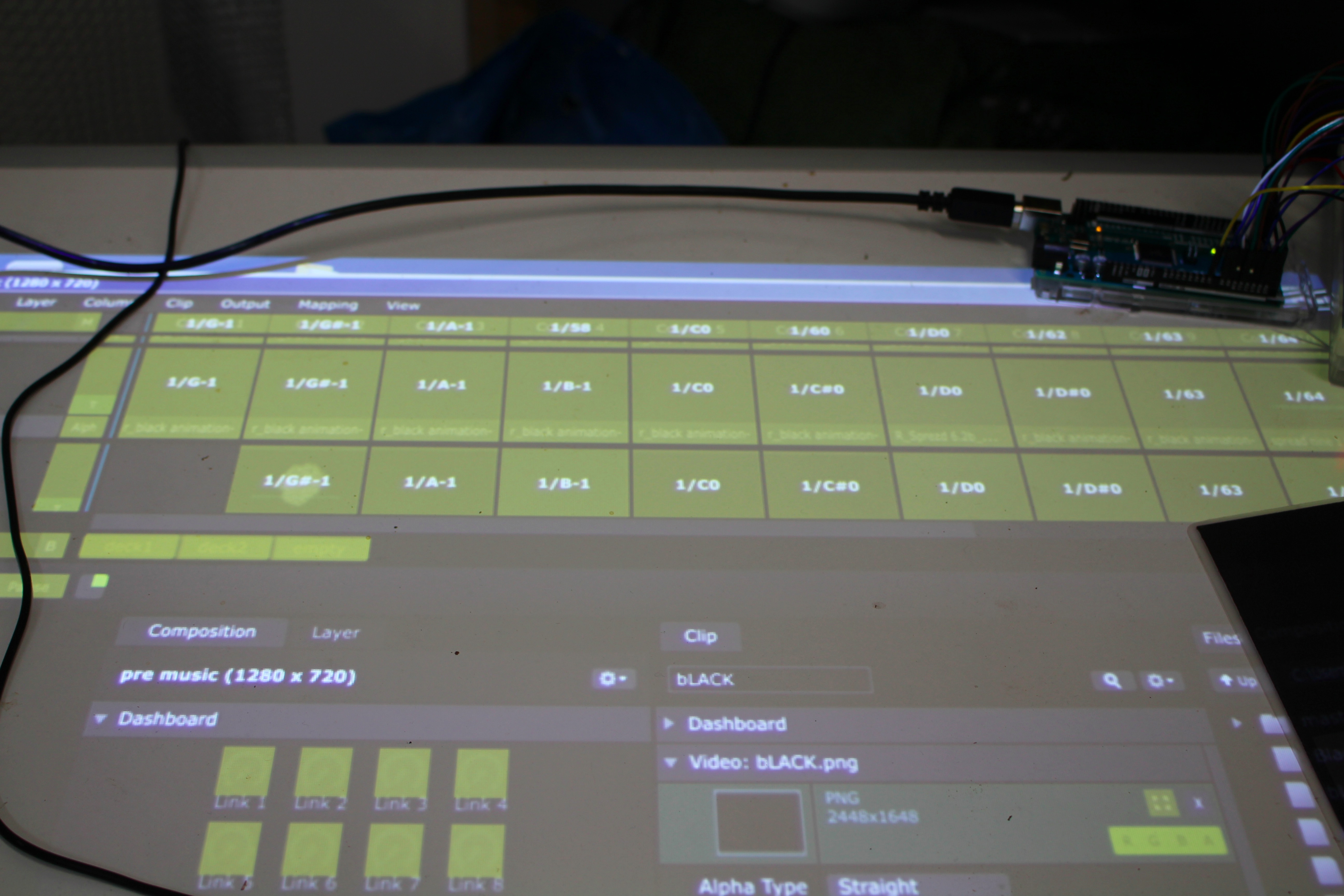

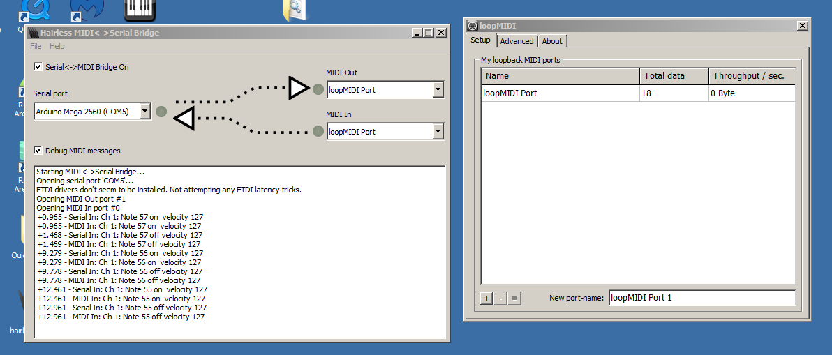

Here you can see a still of the mapping having worked successfully:
(using baud rates of 115200 in both the arduino code and in Hairless)

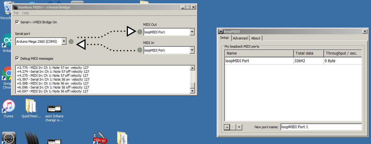

What I've done is made several screenshots to help illustrate what's happening.

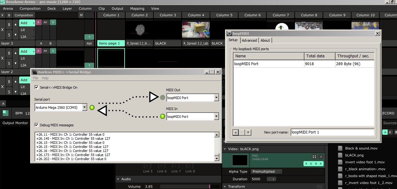

So this is the arduino code, loopmidi & hairless, without resolume 5.1.4 turned on:
It's behaving exactly as it's meant to, notice that the amount of data sent is tiny.

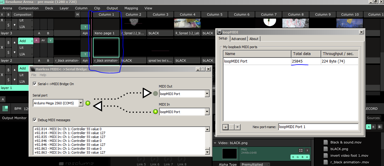

This is where you can see that Resolume has been introduced to the equation and now the part of the code which tells Resolume not to repeat a note is being ignored, then you can see the amount of data being sent is skyrocketing. {at 9,000 ish bytes about 30 seconds in}
This is about 90 seconds on, what you can't see is how layer1, then 2, then 3, then 4 are cycled through rapidly

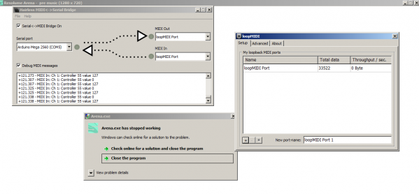

Now it's at 2 minutes or so and Resolume has died:
And then with Resolume out of the equation again it levels out and behaves as it should again:
The thing that's really throwing me off is that this same very code (prior to your suggested edit) has been able to function and correctly 'hear' and composition map and also deliver the right layers as per the notes called correctly, on both arena 4 or 5. So in other words, the ambition of the job has been achieved already, yet some unknown influence has meant that Resolume now decides not to 'hear' things as it had. I'm just running out of possible avenues of things to change.
I've gone to the rounds of starting with a fresh version of windows 7, made a backup of it before any software, then another backup after installing all the relevant drivers etc and the version I'm using now is totally fresh.
Perhaps there's a lead in these screenshots?

You can see in the midi debug window, that you get the midi back to hairless,
I don't think you process that in the arduino so you probably don't need that input.
I think resolume is crashing because in Preferences, you have midi output enabled back to the loopmidi device, which will make resolume crash as it has to process the midi, then send it out, then process what it sent out and so on.
