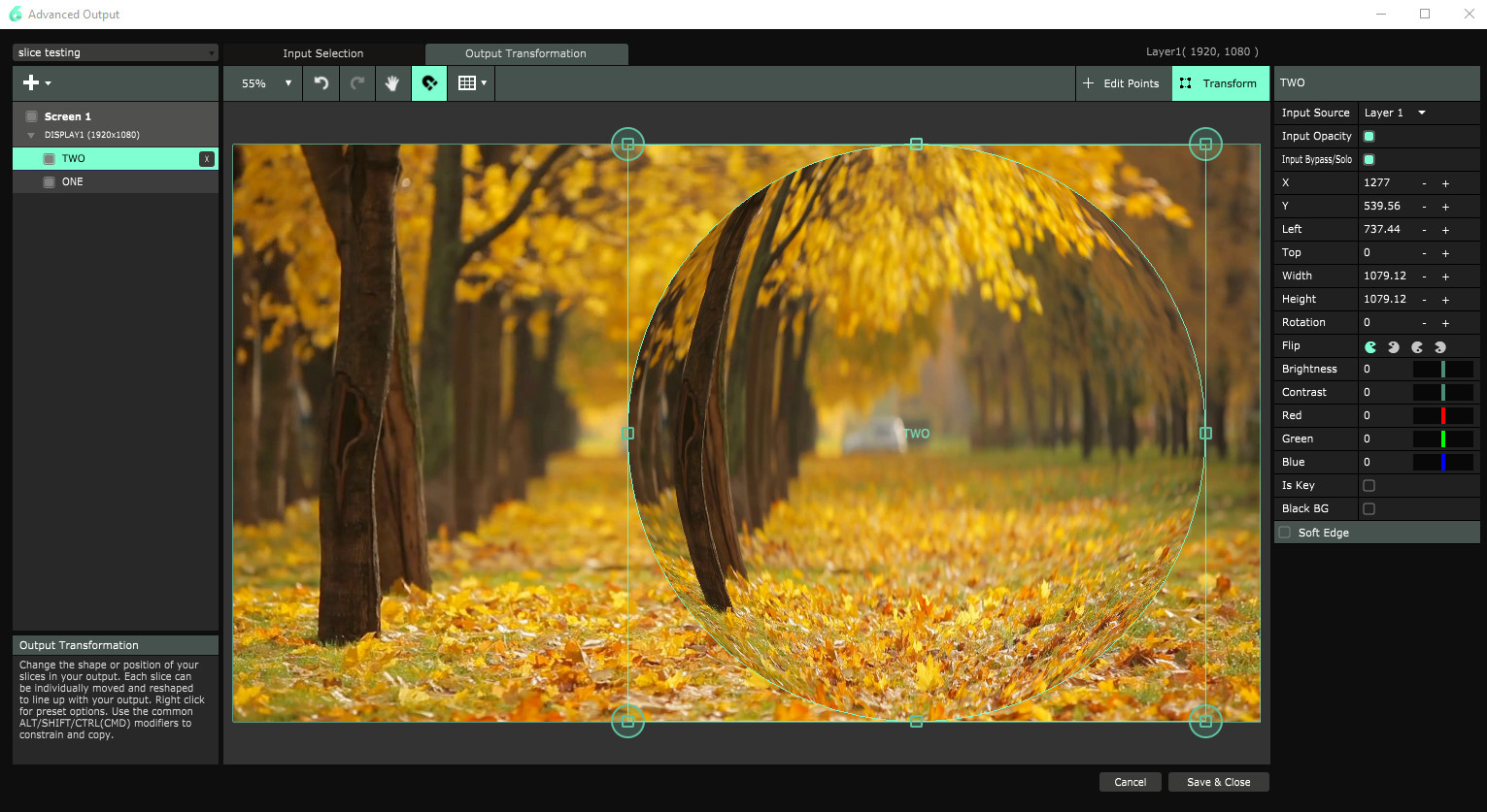

"use all your advanced output slices in the composition/layer/clip level and it can be mapped." can somebody help me out on this, I couldn't figure out how to do this. I am on a award project and wanted to create a lot of different layout with the slices but earlier i used to load the different presets on the advance output but now as mentioned by the seniors i came to know that on and off of slices can be controlled by mapping. Please help

Hi. I am attaching an image file to show what my requirement is, Please check the image file.
I have created 2 slices from the same layer1, slice one showing the full screen the output same as the input and on slice two i have created a "make circle" from the same layer1. now on live what i wanted is to switch on and off these slices without opening the advance output window screen.
