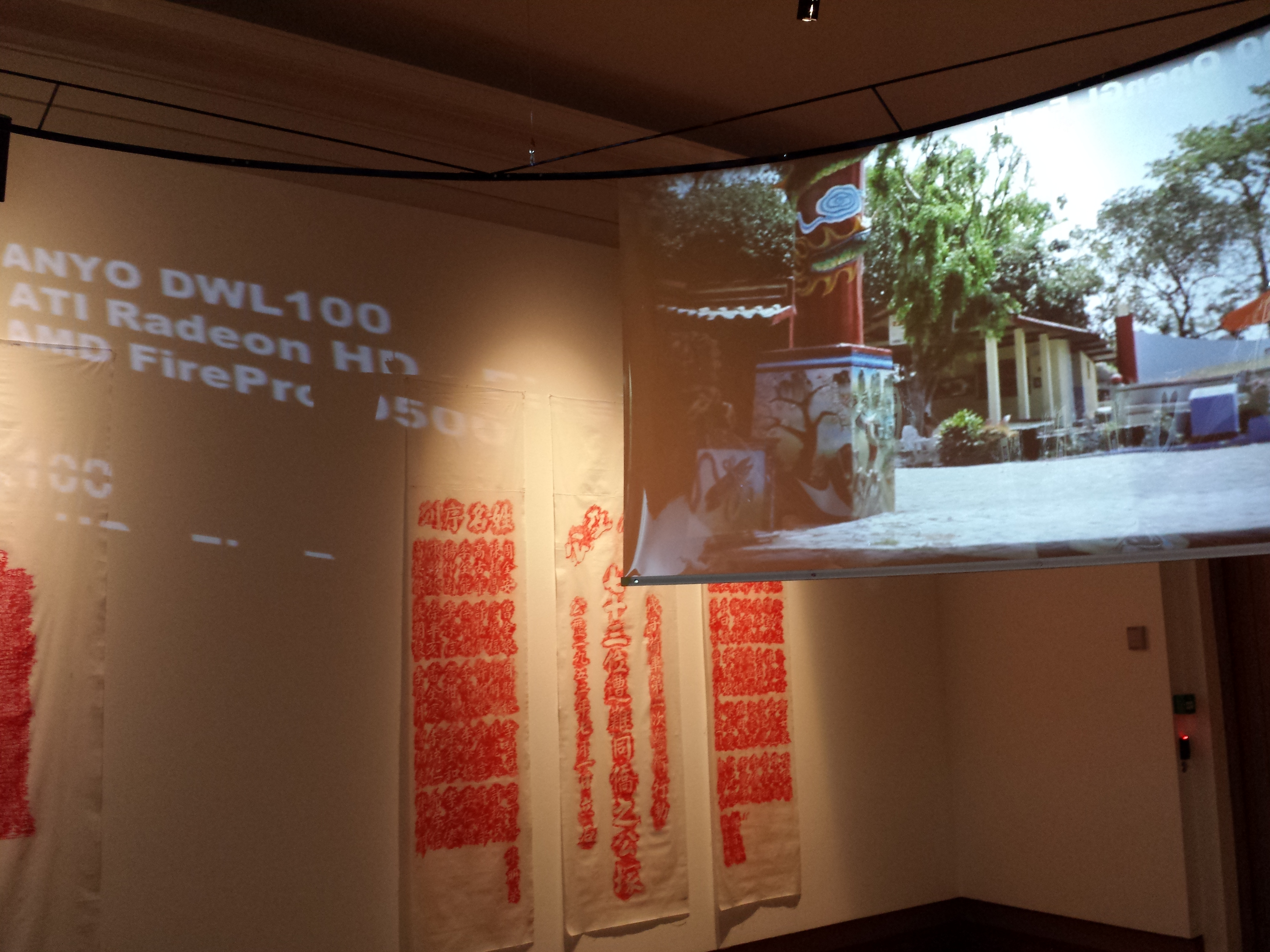

Hi.
We have a mapping installation running in an exhibition. The mapper guy left now but as we tried to re assigne beamer to output, we had this problem. The mapping is there but on the rest of the projection frame there's infos about beamer and other hardware appearing.
Any tips?

Re: Hardware infos mixed with mapping image
Output menu - Show display info is switched on.

Thank you! 8-)
