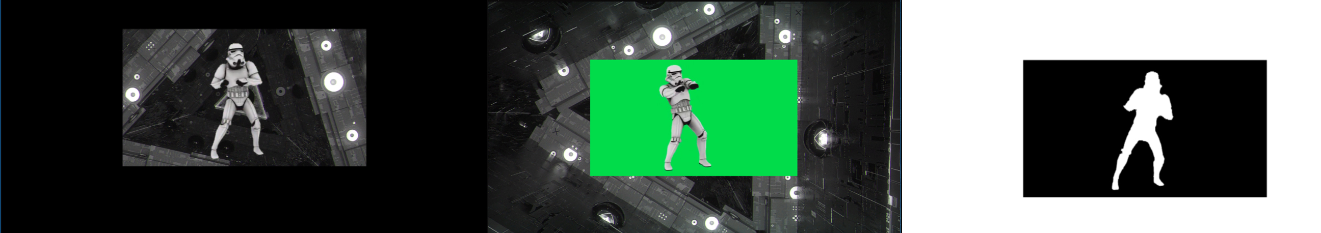

Hey guys,
I have a problem with the chroma key effect in 6. When I use it on a clip it, masks everything around the actual clip. In the 5th version it worked like a charm and was only applied to the clip itself, but now everything around the borders turns black. Maybe someone had the same problem?
Best regards
Adrian

Re: Chroma key in Arena 6
try moving the chroma key before transform
Post by mightrian »
Oh man, I should have thought of that. Thank you thousand times! :)
