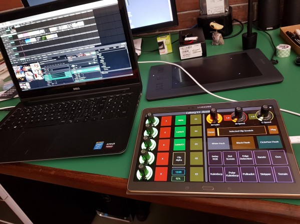

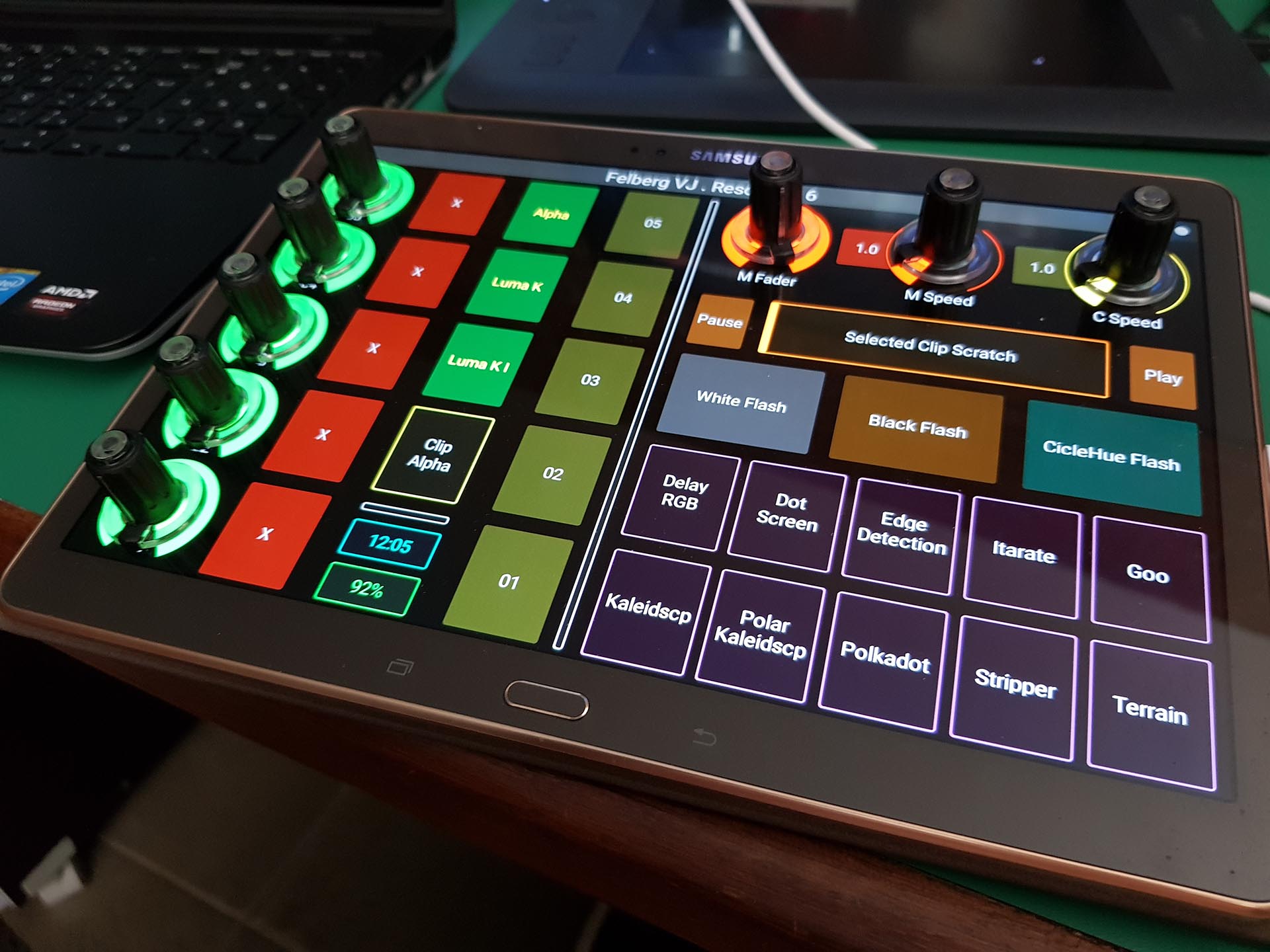

There it comes, my first personal and custom layout for Resolume 6. Fully functional, with the usage of Tuna Knobs.
All syntax was fixed and it is working properly.
