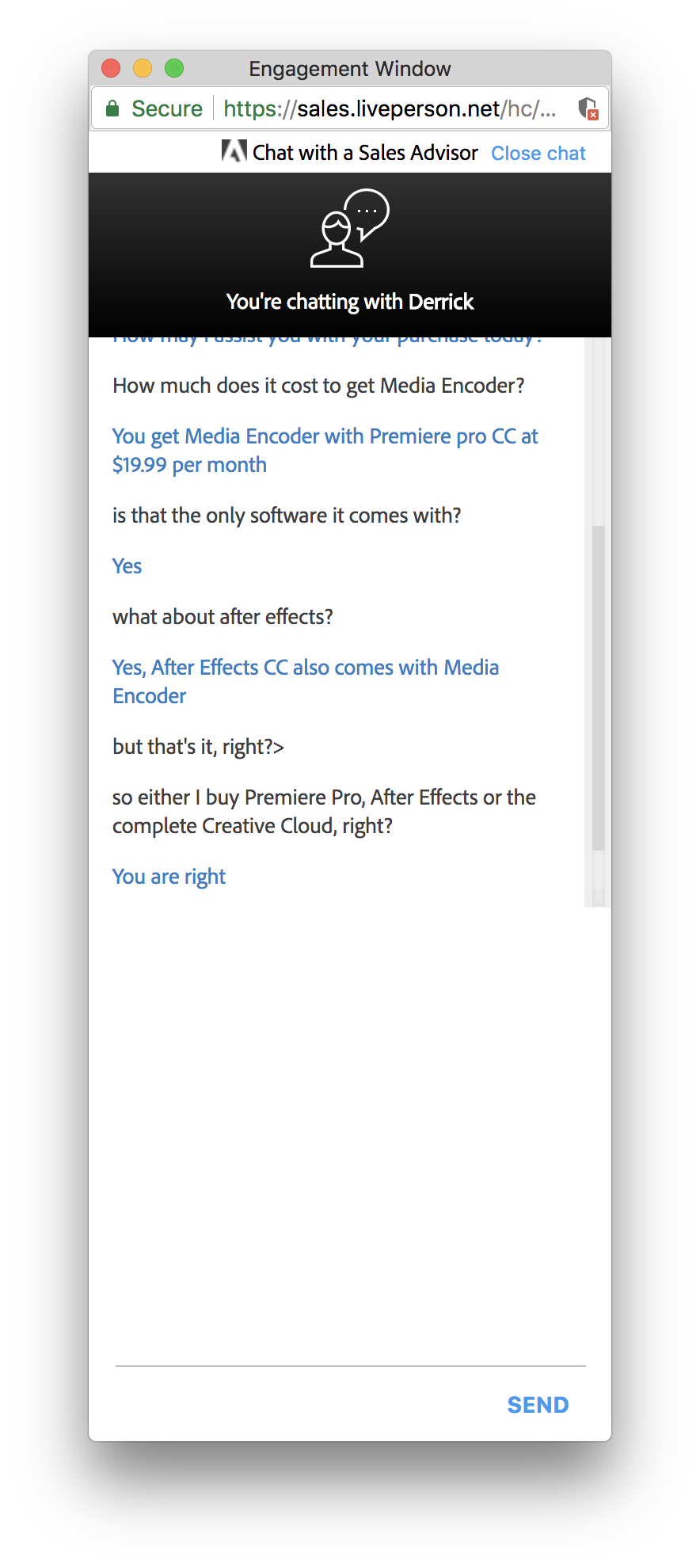

subpixel wrote:Adobe Media Encoder was the one thing that made me cave in and get an Adobe licence; which is currently Over $70 per month (the price went up about 50% since subscribing).
Adobe Media Encoder is currently free!
Re: DXV codec(s)
Your statement took me by surprise so I had to check with Adobe.
AME is not available as a standalone software from Adobe but you're right it is "free" when you buy a Single App for or All Apps respectively $19,99/mth or $ 49.99/mth when you buy a yearly plan. So, if you purchase After Effects or Premiere Pro, you're right, it is "free"!
https://www.adobe.com/creativecloud/plans.html
....an Adobe licence; which is currently Over $70 per month (the price went up about 50% since subscribing).
It's currently $74.99/mth for the monthly plan but $49.99/mth if you get a yearly plan so it might be worth considering getting a yearly plan.
