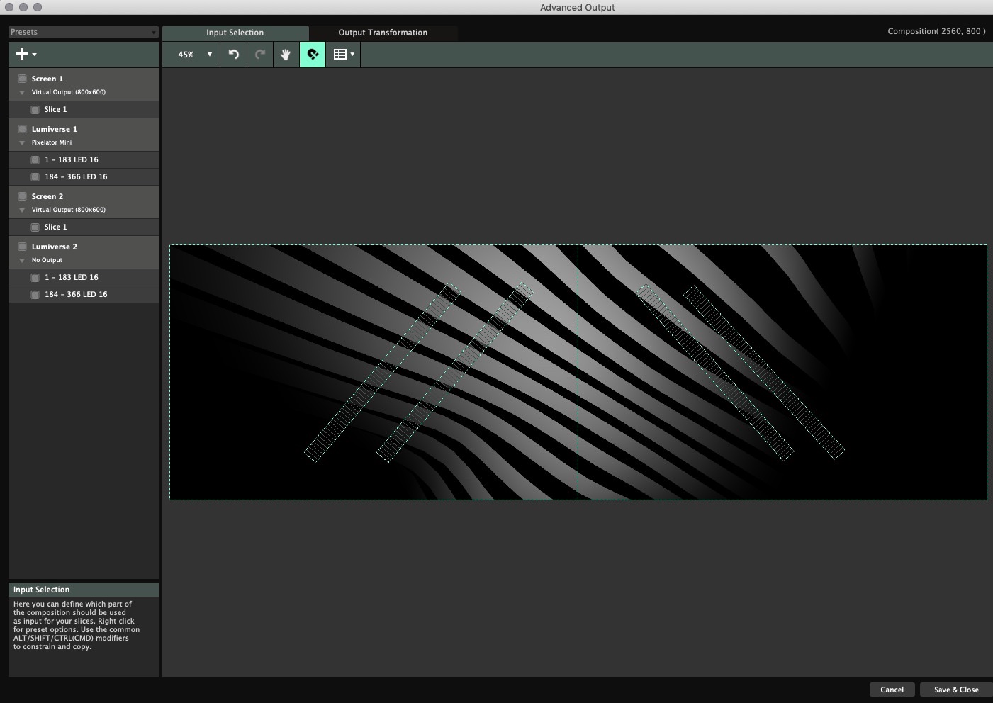

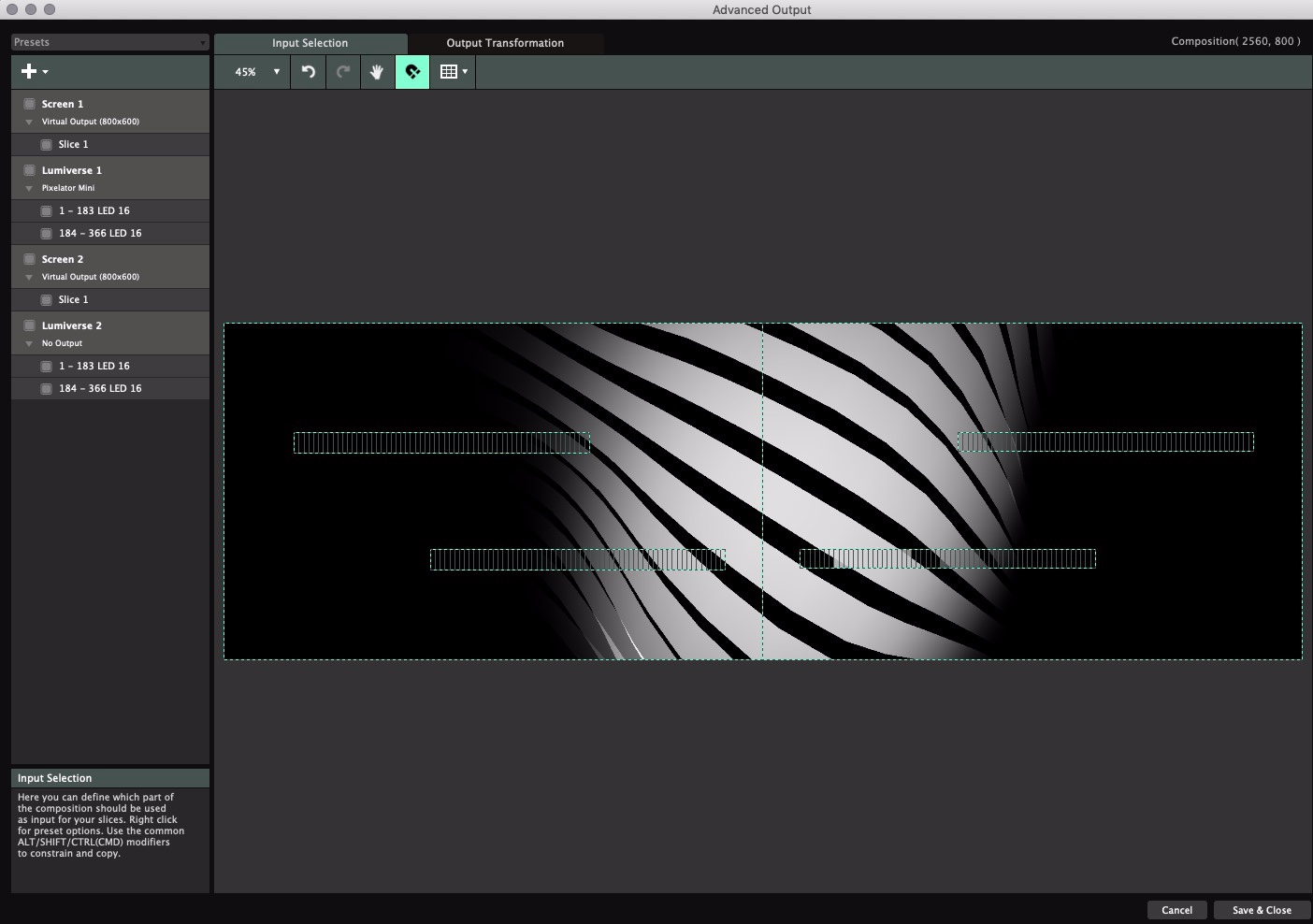

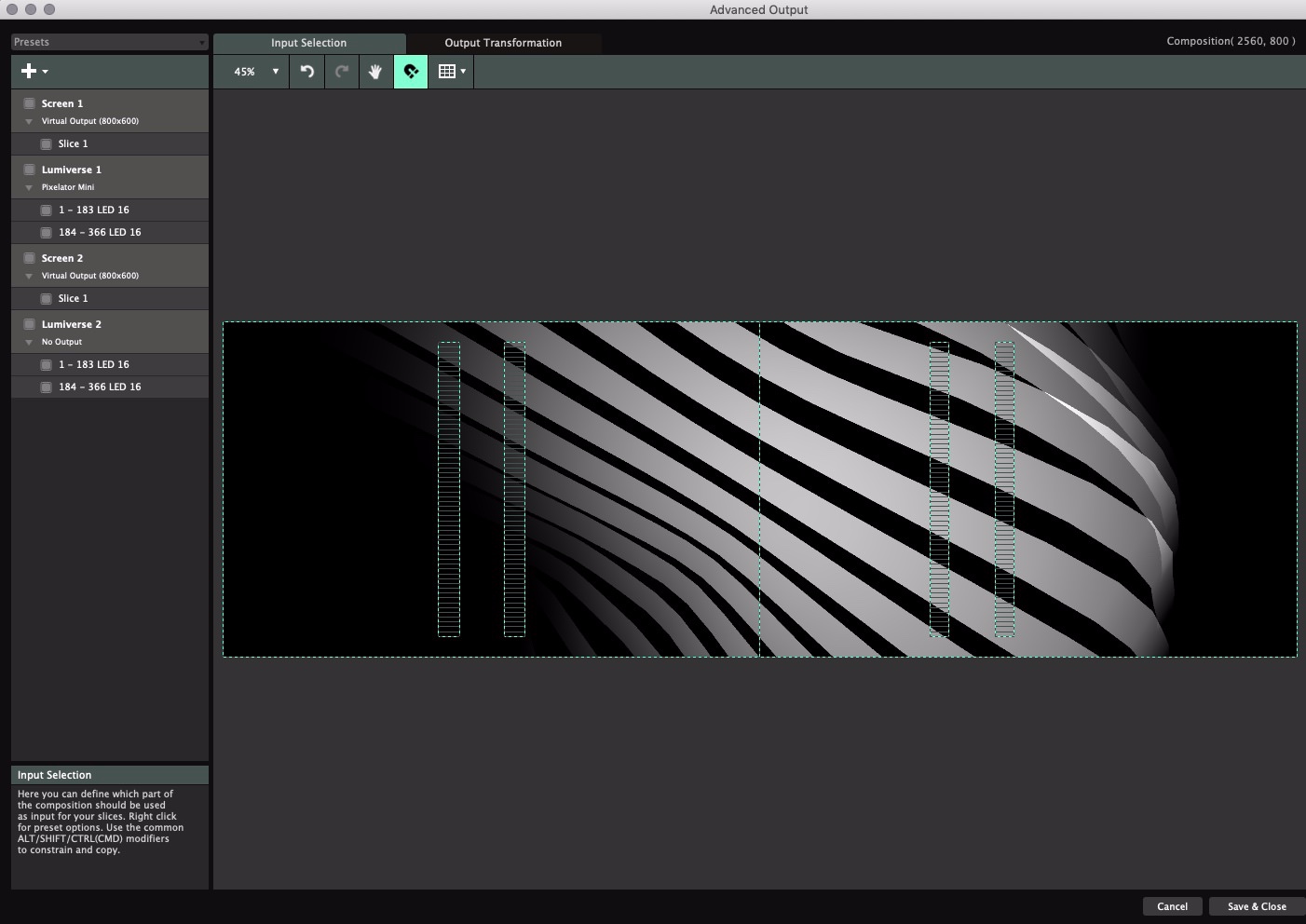

True Joris, that the addressing does not change when they are moved. But from what I understand, you can just have one setup for all the lumiverses and fixtures. So that if I want to mirror a video on to the Pixel tapes, they need to be in the same position for the video to be presented correctly, or?
As an example I would love to be able to change the position of the fixtures as the images shows here. Via osc or similar... Is there a work around for this?
Well, the Input Selection position just defines which area of the composition is being used to sample pixels from. Changing those pixels in the composition would mean you sample different pixels and thereby output different pixels. For instance, your third look could also be created by keeping the sample orientation the same, but rotating the left half of the comp 45 degrees clockwise, and the right half 45 degrees counter clockwise.
Now I understand that that is not always an option, and quite probably more work than just setting the sample position and orientation. Personally, I'd struggle quite a bit to make your looks without resorting to some complicated router structure or custom FFGLs.
