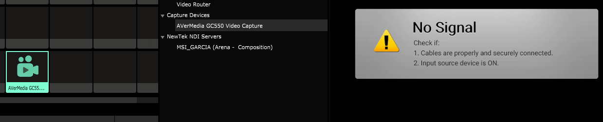

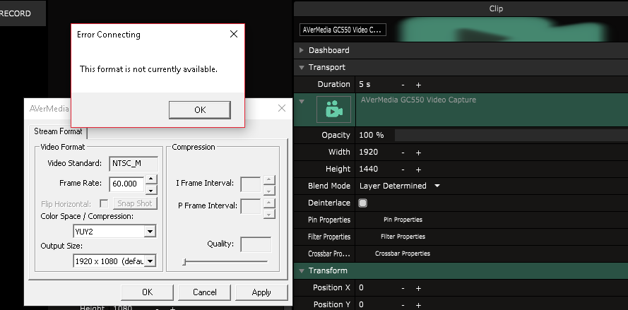

You even got submenus for that card, change card resolution etc...but it all ends in an error. I would say that resolume is not compatible with it but what's making me mad, is that it detects even on the output monitor the card, but the error message. ( Pics below)
Outside resolume as i said, no errors, just what i am capturing. Any future support on that? :P 4
The menus and submenus:
No signal, however, it captured that no signal message through the card ( see the Avermedia Logo), the error usually is to change the resolution ( when on resolume), but the menu has the option, but does not allow to do it
(the right pic is the output monitor inside resolume cropped)
