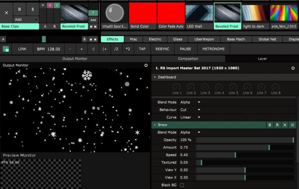

I think there might be an issue with the Snow plugin. When I add it, I can't see anything below it. Like the "Black Background" check box is on all the time. But it isn't checked. I just see a black background all the time and some video color below it in a couple of the snow flakes.

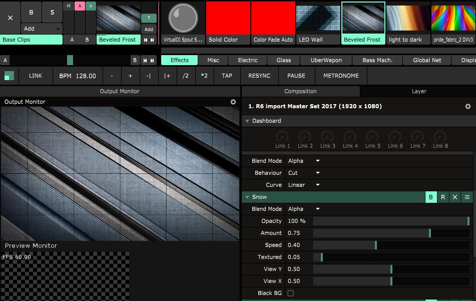

Background video with Snow Bypassed
Snow with no Alpha and Black Background unchecked
Re: "Snow" plugin built into Res 6
Can you drag the snow fx into a blank spot in the clip section of the app, one layer above what you would like played (or on the to layer) seems to work that way.
I just dropped the fx into a blank clip when i play it, never tried adding to an effect. i see your problem, there's no alpha on the effect, just a black bg.
This is not so much a problem with the Snow plugin, as with the way blend modes work for effects that create alpha. On 6, we've taken a babystep towards addressing it, but it's going to need a lot more work. I've always considered the Black BG a hacky bandaid fix for this deeper lying problem.
If you want to see both the result of an effect combined with the original input texture, you can adjust the opacity and/or blend mode of the effect.
