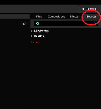

No they don't... but if I understand you right.. you want to see the live input ..LIVE on your screens on stage?!
Attach and eventually install your capture device to your Resolume computer...and it will show up here in Resolume:
Just drag the source like a regular clip into your clipdeck... and use it like a clip.
Here in the manual on page 72 you'll find the chapter about "Live Inputs"
