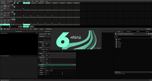

Foresight
Posts: 9
Joined: Fri May 19, 2017 00:05
Location: New Zealand
Re: Resolume 6.0.7 have to force quit!!!
Post by Foresight »
Having a similar issue.. Resolume 6 won't open properly, Just hangs on the opening screen as shown in the attached image.
Running latest windows 10 and nvidia drivers. System spec as follows:
Intel I7 6850k
2x Quadro M4000
Asus X99 Deluxe MB
Smasung 950 evo pro
Intel PCIE SSD 750 series.
Any assistance would be greatly appreciated. Got a show coming up this weekend.. Have never experienced something like this. Machine had been running 6.0.2 fine then just randomly started having this issue. Updated everything but with no improvement.
"The earth without art is just eh"
Nocturnal.nz
Posts: 7695
Foresight wrote:Having a similar issue.. Resolume 6 won't open properly, Just hangs on the opening screen as shown in the attached image.
Sent you a PM,
This looks more like viewtopic.php?f=12&t=15939
