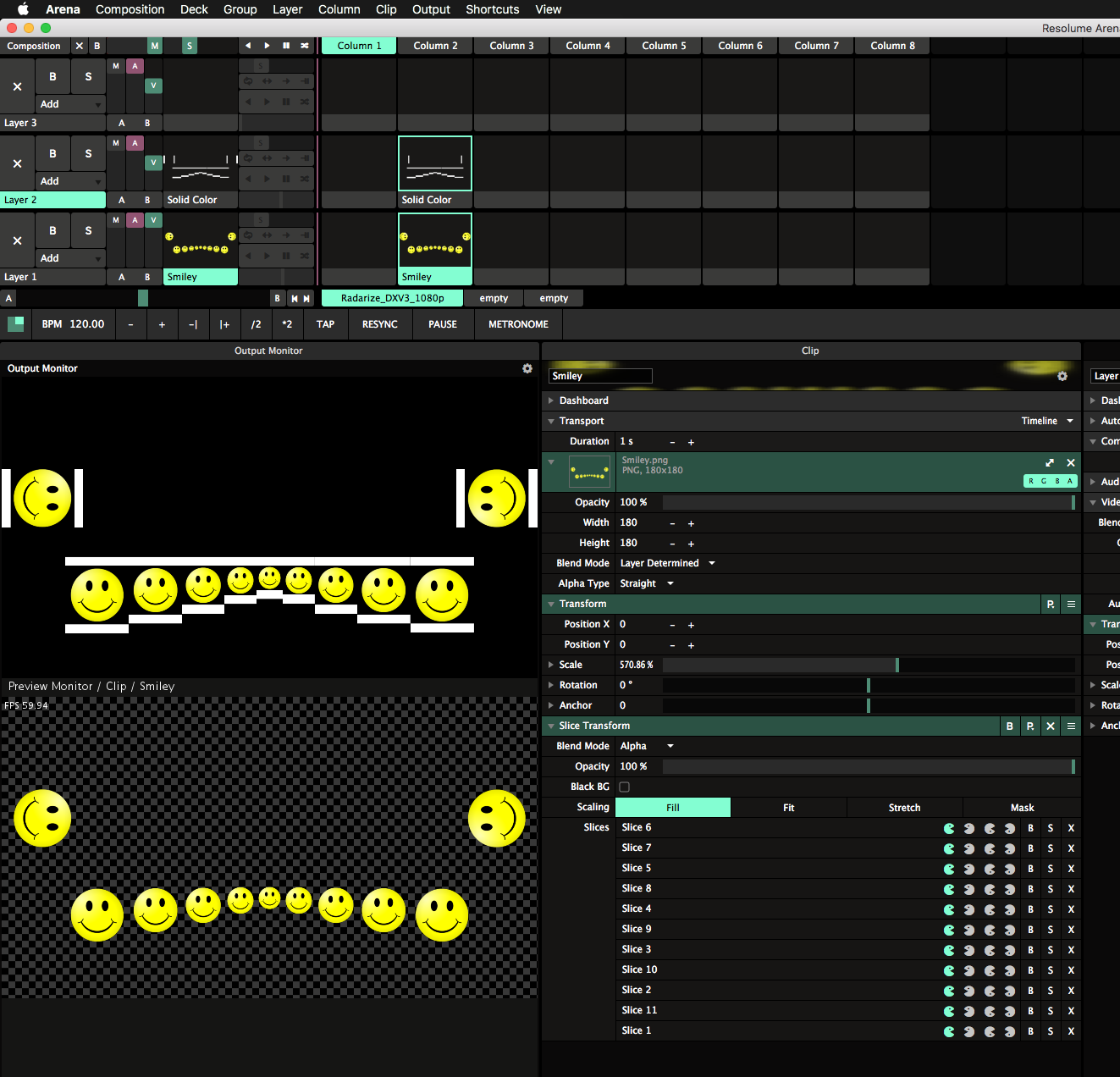

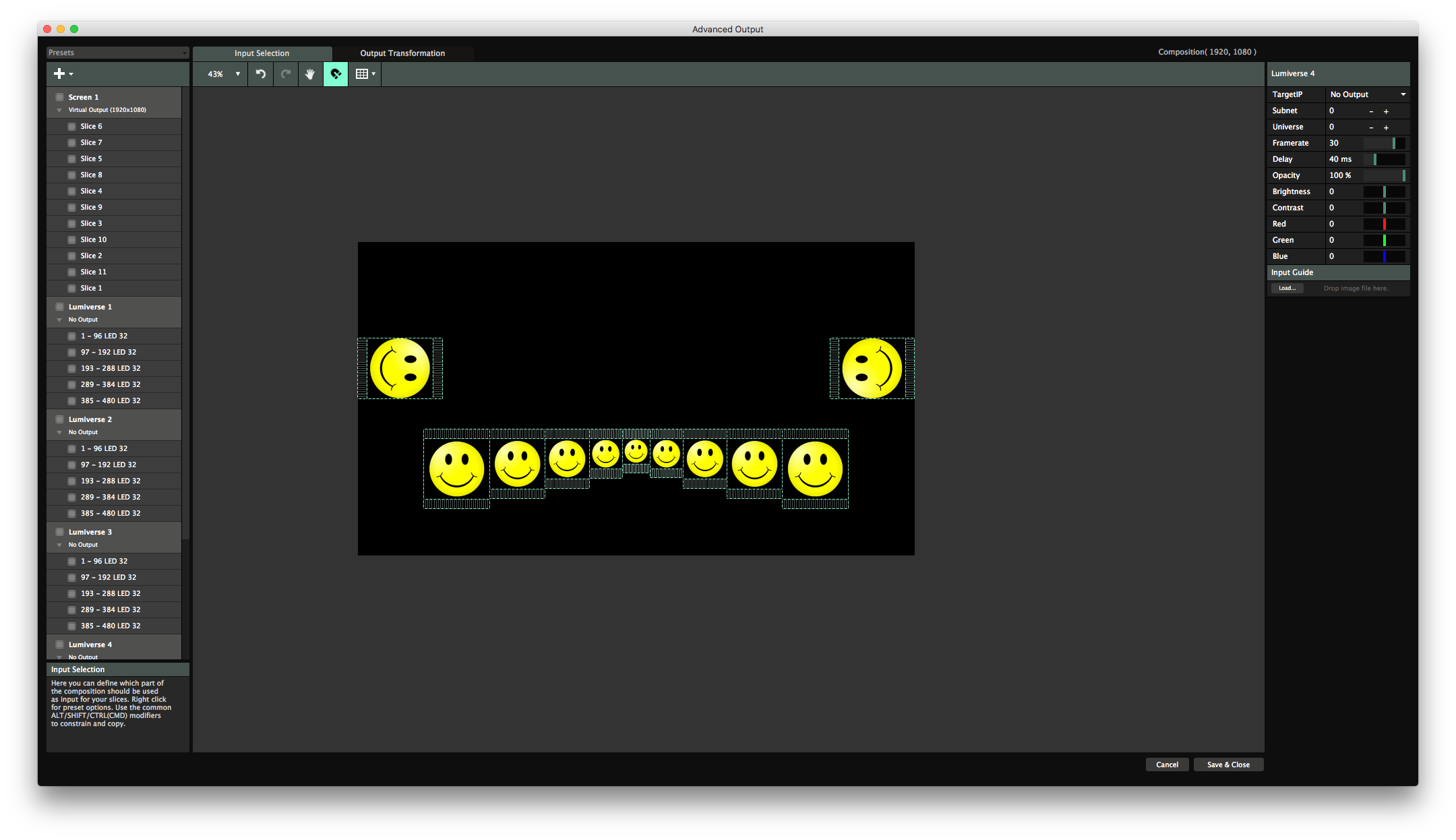

Going from your setup pic in your other thread, I would lay out my input slices like this. One drum = one slice.
If I wanted to play the smiley over everything, I'd just bypass the Slice Transform effect. actually, I'd set the Slice Transform effect to Mask, to prevent the smiley from showing on the LED strips.
I'd probably want to control the LED strips separate from the video, so I have them on a separate layer, and they sample just above and below the video slices. If you just want to flash them along with video, you could place them within the bounds of the video slice representing the drum they're on. That way, when you put video on the drum, the LED turns on automatically as well. Your call.
