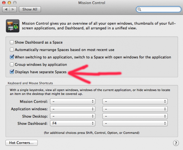

What kind of macbook pro is that, does it have dedicated graphics?
Do you have "Displays have separate spaces" enabled or disabled?

elbundlo wrote:Not sure what you mean by "Displays have separate spaces", but in display preferences mirror displays is OFF.
It's a settings you can find in OSX system settings - Mission control:

Posts: 7712
Re: Output problems
elbundlo wrote:I have a problem outputting with Resolume 6 with my MacBook Pro.
In settings/displays the arrangement is correct, laptop on left, projector on right, and mirror displays is off.
Try to Start Resolume, then right click on the Resolume program icon in the dock and hover over Options,
then select the Assign to None option.
You only see this option if you have multiple desktops, which I assume you do, or did at one point.
If you don't then create some to see this option, looks like it's sticky even if you don't have multiple desktops. because... OSX...

Posts: 7712
Re: Output problems
This one looks to be an OS level thing, where OSX forces the output to certain displays.
I don't think we can do much about that if you have these settings mentioned in my previous post, so you need to check those out.
