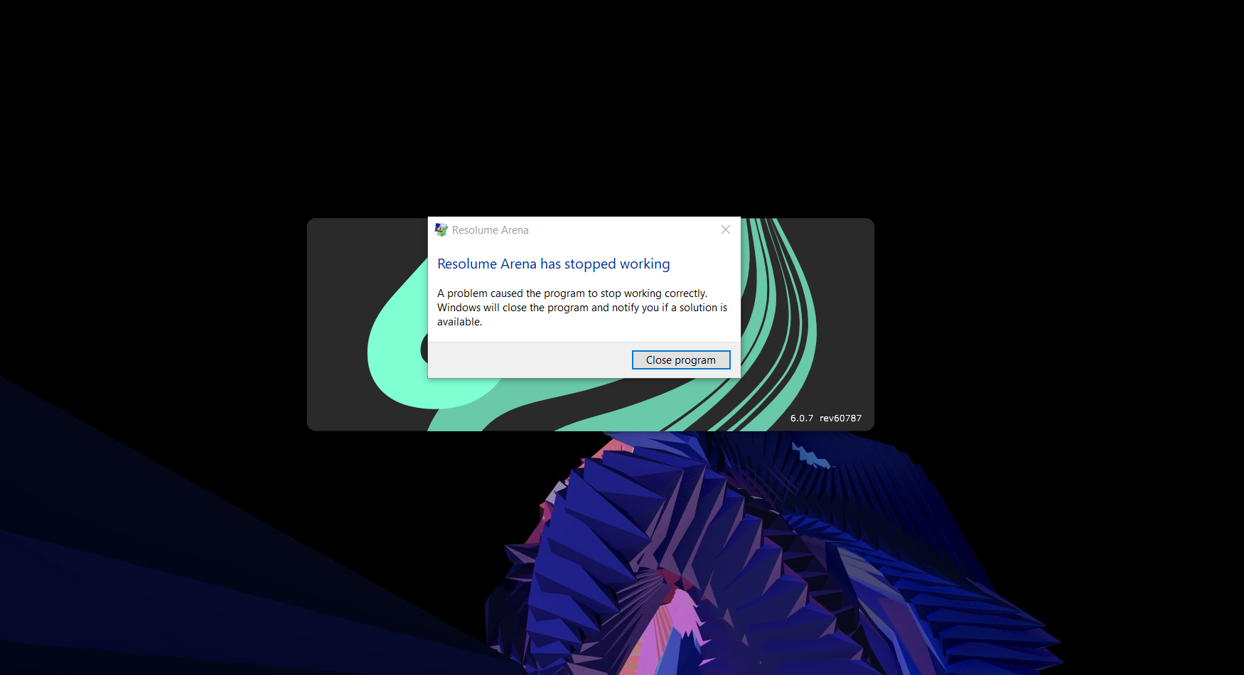

I've been testing out Arena 6 with a new 8th gen i7 MSI w/ GTX 1050ti 4GB + 16GB ram. It's had its ups and downs w/ the whole Nahmlic audio situation, plus I'm still getting used to all the new features in 6. However, I reached a point where I was happy. It was complex composition with 10 layers for individually mapped inputs for slices plus a super wide screen layer mapped below. Everything was working smoothly, and then I plugged in a new APC mini and started mapping. I tried the preset, but went back to my own custom mapping and then out of now where the comp crashed.
Now I can't reopen Arena. I got a notice that it tried to send an error report, but ultimately failed - and now it says 'Arena Has Stopped working' (see attachment).
I've restarted. Shut down. Unplugged external monitors.
Nothing is working, I've never seen anything like it.
The only other thing I really did that was different besides the Midi mapping was setting some Clips to go "pick up where the last clip was, cause why not?" I feel like it's opening the same composition when its trying to open and it can't do it. Do I need to reinstall or does anyone have any other ideas?

Try removing the recentLayout.xml from Documents/Resolume arena 6/preferences.

Thank you, that worked!
I felt a little bad because I hadn't read Joris's thread about what to do for help before I posted, but I actually tried removing some of those other config files, and it didn't work - but yours did.
So I am guessing this is related to the Layout view, which is new to Arena 6 correct? I made my own layout, and as soon as I really started getting into the Midi mapping this happened. Would anyone from Team Resolume want to see the log file, since I'm pretty sure it didn't send?
