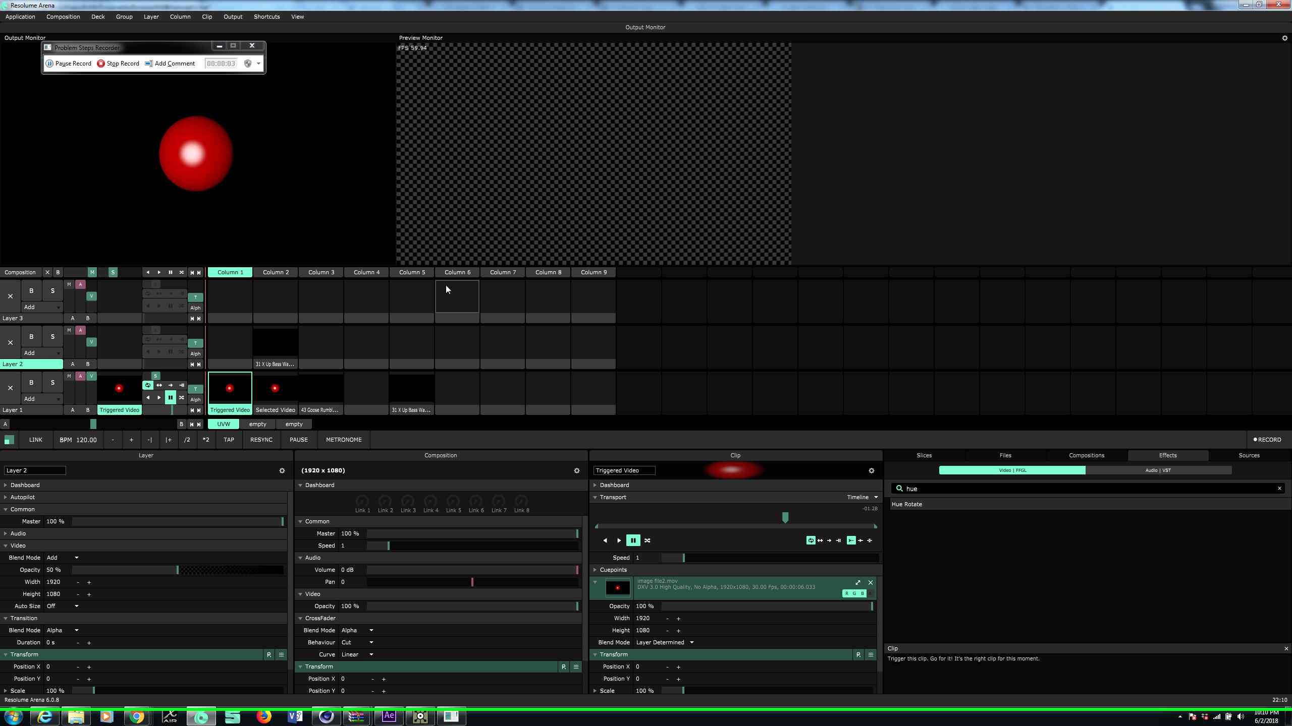

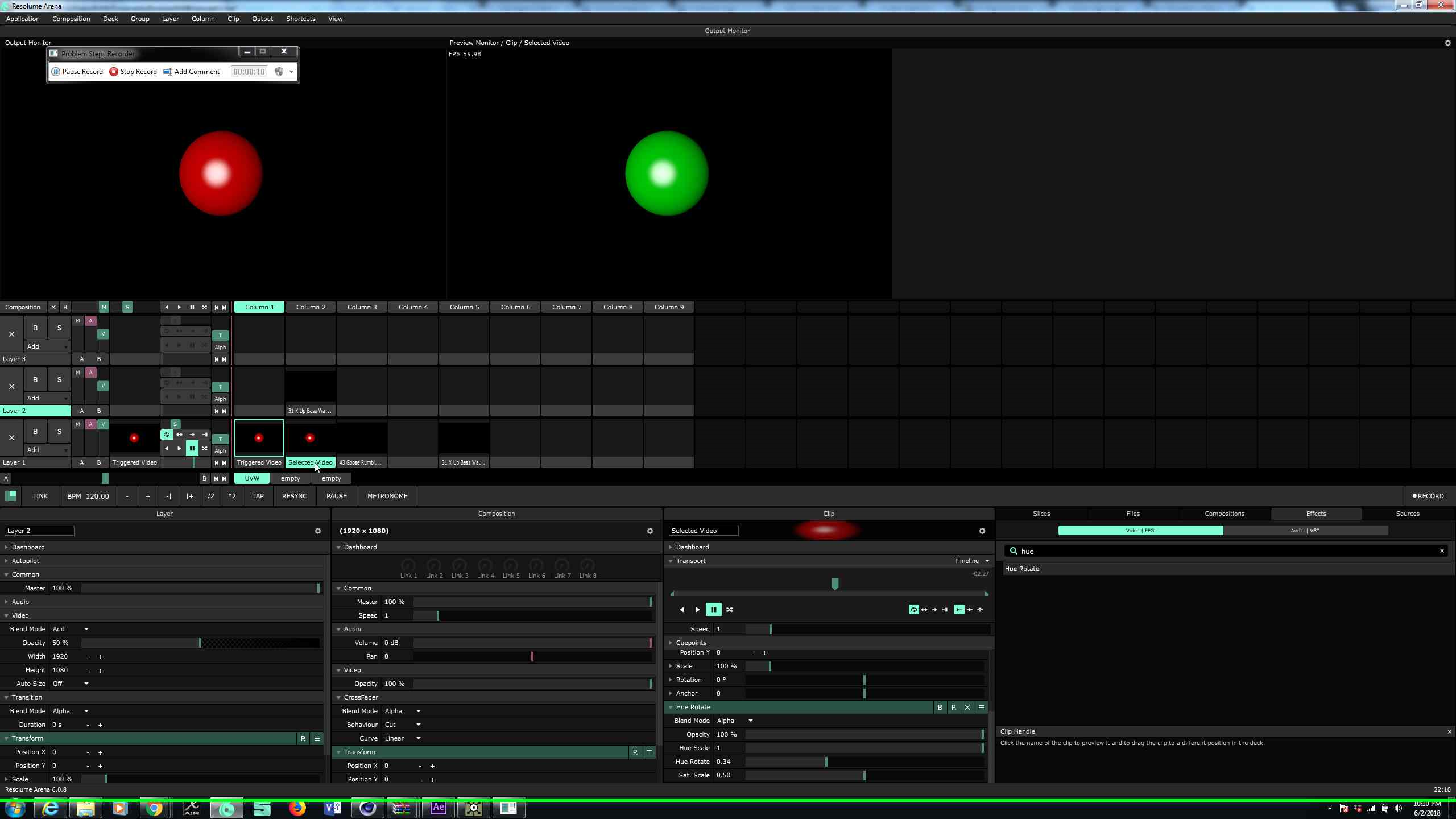

Whats interesting is that i can preview clips on other layers but if i preview a clip on layer 1 it fires out the name of that clip. I kinda expected previewing on layer 1 not to fire out the clip name of the preview clip.
Is this expected behavior or a bug?
I expected
/composition/selectedclip/name to send out when previewing a clip. But previewing on layer 1 sends out the
clip name on
/composition/layers/1/clips/name

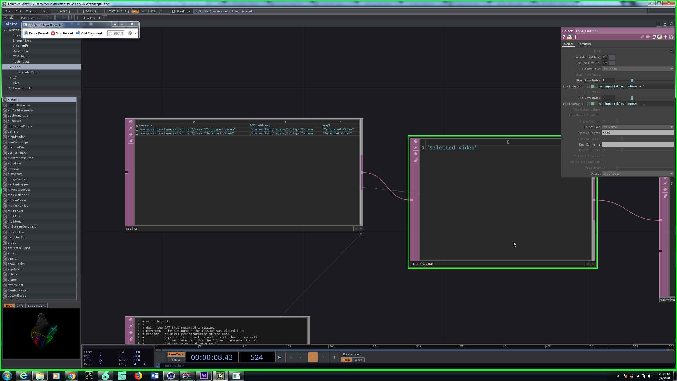

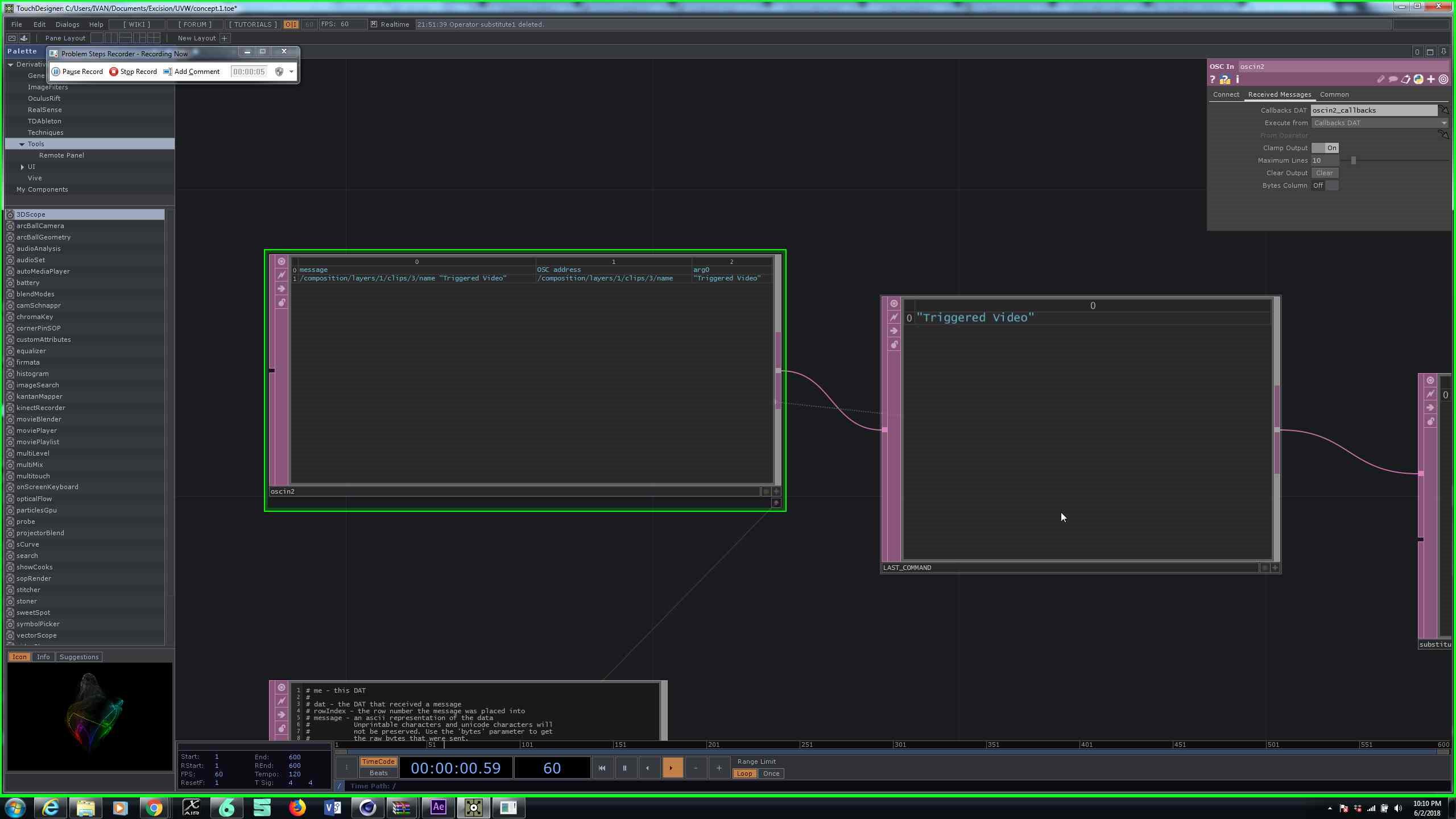

Have screen shots of Touch Designer taking in the OSC commands below.(Just look at the first 4, can't get the forum to delete the others when they showed up out of order.)

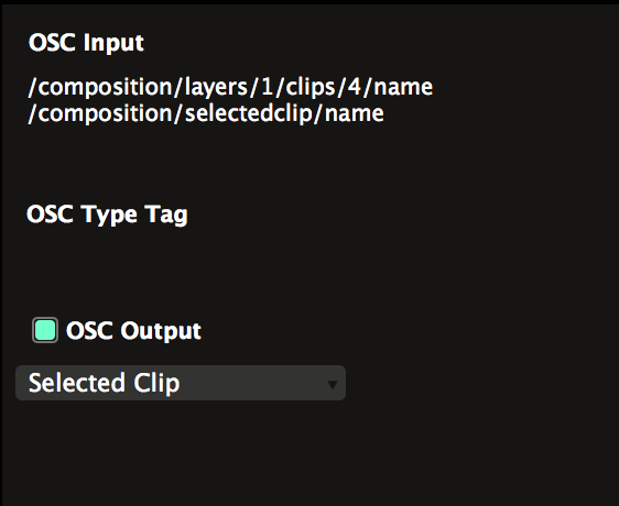

Are you using the OSC output All preset?
If you use custom OSC preset, set the clip name OSC output to Selected clip, to get the name on select on the /selectedclip address
Képernyőfotó 2018-06-05 - 12.08.16.png (29.24 KiB) Viewed 5321 times

Zoltán wrote: Tue Jun 05, 2018 11:05 Are you using the OSC output All preset?

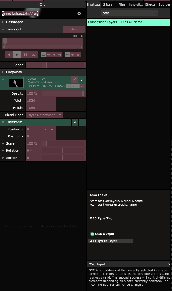

Just triggering with mouse and autopilot. OSC is only going out, it is not going in.
-The OSC mapping is literally only this value so i've attached a screen shot.
-It's going to touch designer as you can see in the screen shots above.
Right now i'm getting the clip names which is great, i'm just getting clip names on layer one for triggering and selecting.
I assumed
1./composition/layers/1/clips/name would send me the name of the triggered clip
2. /composition/selectedclip/name would send me a selected clip
Right now /composition/layers/1/clips/name is sending both trigger and selecting.
Thats why i'm asking if its a bug or expected behavior. Maybe if i'm looking at /composition/layers/clips/name this would give me the behavior i'm expecting. I'm just unsure how to enable that outgoing OSC command via the GUI.
