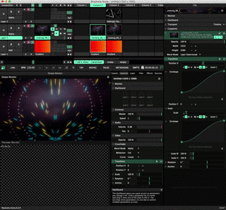

You could do this with scale and position parameters animated to timeline, play once. On one of the capture clips the animation would make the clip smaller, on the other the opposite:

awsome Hint.... timeline play once.... all we needed.... I sell my e2 and nextstage. =)=)=)

Thank all of you very much! It works perfect! ;)
