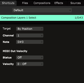

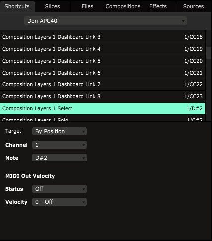

Ok, so here here is the way the layer button was mapped and working previously
Midi map before.jpg (31.27 KiB) Viewed 9907 times

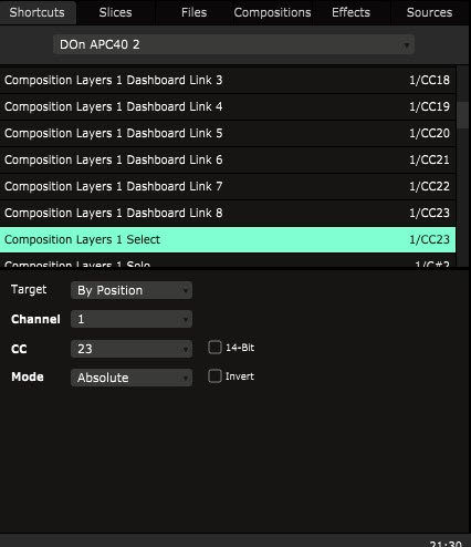

Because that was not working anymore I cleared the Shortcut and re learned it. Looks totally different now with no Velocity settings.
Midi clear and reprogram.jpg (32.52 KiB) Viewed 9907 times
I even notice that the Midi note is different. Both maps should be to the "None" button, just under the Clip Stop #1 key. Again, only the layer select keys are giving me an issue. All others seem to work fine.
Posts: 7712
Re: Midi map layer select issue 6.0.11
Midi mapping stores the last received command from your midi controller for a shortcut.
Looks like you touched a dial, when you had the layer select mapped, the same dial that is mapped to your Layer dashboard link 8. (CC23 is the Device control knob 8)
It sends a Controller change message instead of a note. That's probably not what you want for layer select.
The first image looks about to be correct to me.
D#2 is what I get when pushing the channel 1 "none" button on my APC40mp2 AND have Midi middle C=C3 selected.

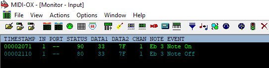

Thanks for the help, after reading what you said I now have a theory. The layer buttons worked fine until I mapped those top control knobs to each layer's transition time. I can assure you that I did not accidentally touch that knob all 10+ times that I have tried clear and reprogram this. So I wonder if there is some kind of feedback going on here. To isolate it (and because I don't have my gig machine here) I hooked my APC up to a different laptop and installed Resolume as a demo. Here is that "None" button working as I would expect on another machine:
Here is the Midi OX data for the same "None" button:
Midi OX.jpg (21.72 KiB) Viewed 9881 times
