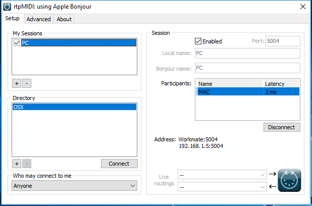

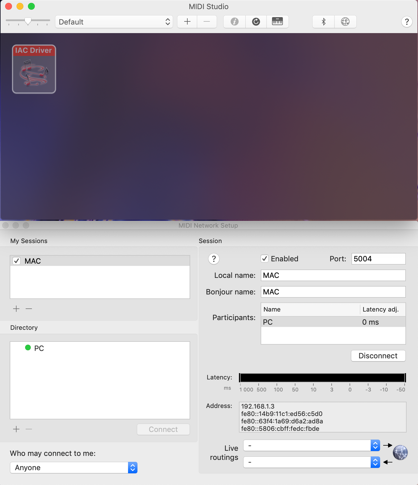

I need to send midi signal from Anletone (on PC) to my Resolume Arena (on MAC)
I`ve connected both laptops via ethernet cable and using rtpMIDI make a session.
But have no idea what to do next, because of in MIDI Network panel i don`t see Network icon..
Also i have misundrestood about ip addresses - they are different now (see screenshots) but i can connect my laptops anyway
So i need your help
Posts: 7712
Re: Midi sync to PC and MAC
Looks like the connection is already set up.
If you see the participants connected then it should work.
You'd need to select the network midi devices in the programs still to have them communicate.
