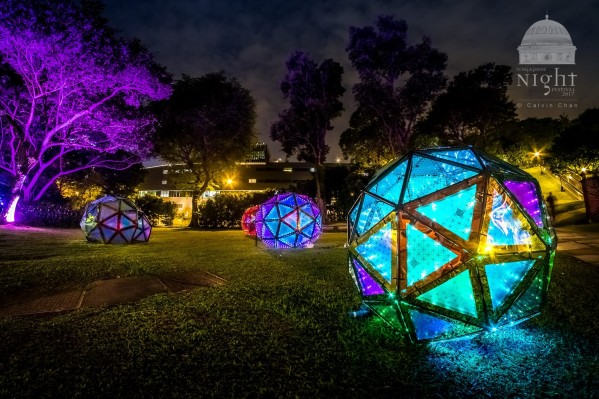

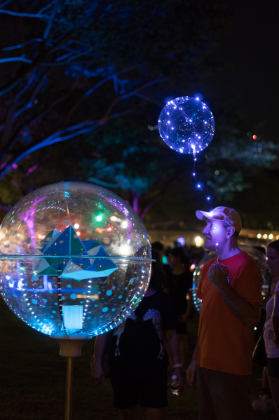

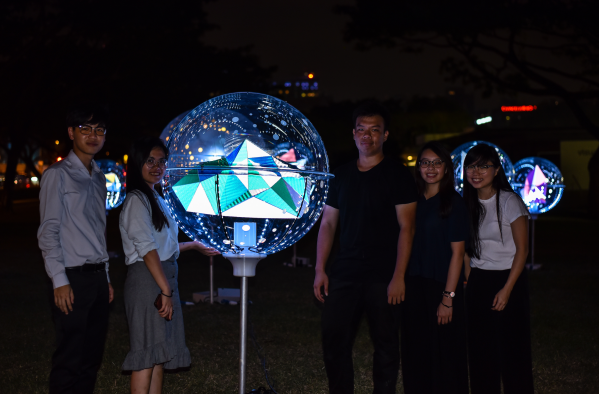

Orbit is an abstraction of our solar system; 8 planets around a sun. Each of the planets and sun are individual units and react when the visitors spin them. The LED lights inside illuminate the planets and its unique make-up.

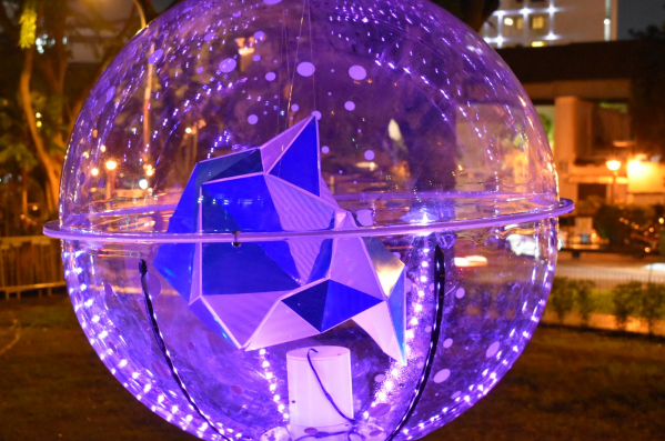

Within each planet is a unique polygonal gem, covered with retroreflective material. It is this gem that lights up with the use of flash photography or videography.

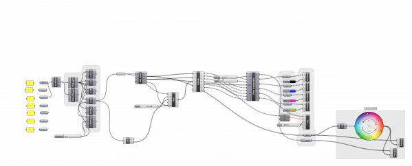

This gem is made computationally with the use of Grasshopper, cut on a corrugated board with a zund cutter, and assembled by hand.
Grasshopper script used to create the gems

While stationary or slow speed, the planets glow at half-brightness.
At high speeds, the planets will then glow at full-brightness.

Hardware design was one of the most challenging parts of us, as this is our first time designing an interactive installation for the outdoors. There were also no off-the-shelf components for the curvature of each sphere we were using, so we had to design some components from scratch while trying to use as many off-the-shelf components as possible.
We went with an Aluminum tube for the shaft as it was easy to cut and was very sturdy at 40mm diameter. We opted for a brass bushing due to its low maintenance and low pricing.
We used a slip ring connector to transmit power from the stationary shaft to the rotating spheres. This is the centerpiece of the installation, the interface between the stationary aluminum tube, and the spinning sphere. Finally, the sphere holders were 3D printed in PET-G. PET-G was chosen as it was more heat and weather resistant as compared to PLA, important in the Singapore climate.
In our earlier versions, we were able to engage a printing service to print it as a single piece. But this single piece print took too long and demanded a large print bed. We then designed a split version so that each piece is printable on common print bed dimensions. The split versions aligned with each other with printed pins and holes. Split sections were secured with a PVC tube section and also when the attachments are screwed to the sphere.

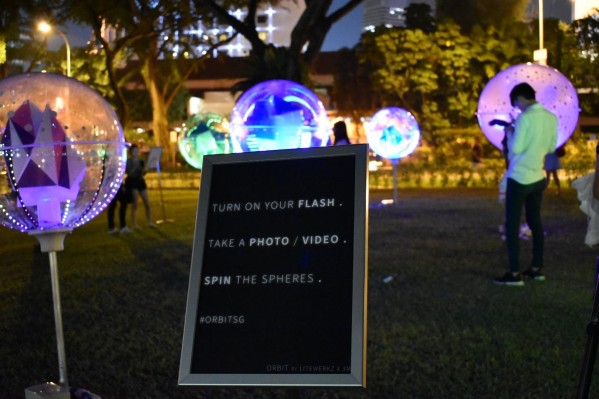

What this meant to us as artists, is that this material gave us an opportunity to design experiences that were unique to each individual’s perspective, and we sought to exploit this property in our installation. We encouraged visitors to turn on the flash on their camera phones while taking a photo or video, which would allow them to see the effect of retroreflection unique to the perspective of their camera.

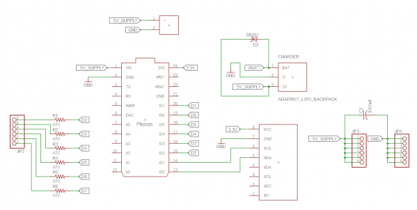

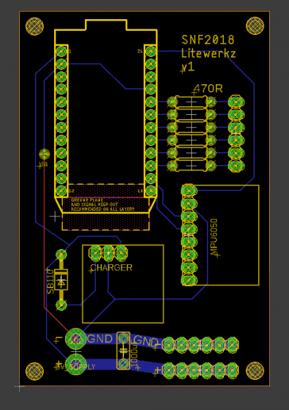

To put all these components together, we designed and printed a PCB. This PCB sat in the centre of each sphere, in a housing, and spins together with the sphere.
The PCB design allowed for us to easily put together the various electronics components. It also made the soldering and connections more consistent.We added a lithium-polymer battery backup system to prevent the micro-controller from shutting down if power connection is lost when the planets are spinning.
The PCB design was done on EAGLE, a PCB design software that is free for hobbyist and makers (this free version has limited features). The other good thing about EAGLE is that it works well with Fusion 360; PCB designs can be imported over from EAGLE to Fusion 360, allowing for inspections on the sizing with the overall design.

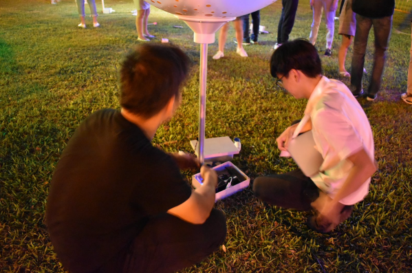

Linking everything wirelessly gave us a lot of convenience, but of course we had to deal with the downside of using WiFi. We noticed that when the festival got crowded, the micro-controllers tend to disconnect from the network, and would freeze on the last received ArtNet frame. We then had to power cycle these frozen micro-controllers from time to time. It could have been interference from mobile phones with their WiFi and Bluetooth turned on, or because our low powered WiFi router was not equipped to deal with 10 simultaneous connections (1 server, 9 spheres).
Apart from these minor problems, we felt that wireless is the way to go logistically.
Interactive installations take the biggest abuse. The PCB was initially designed with female header pins for the outputs but when the wires keep coming out when the planets were spun, we replaced them with screw terminals to ensure that they were held in place.
On the first day of the festival, we witnessed kids and adults using all their strength to spin the spheres as fast as they could.
