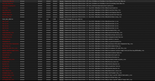

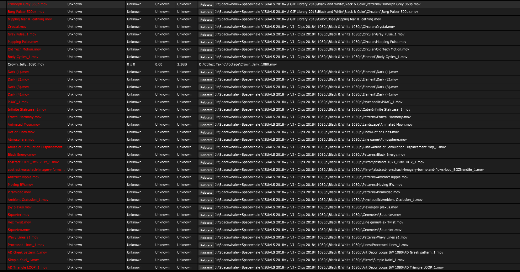

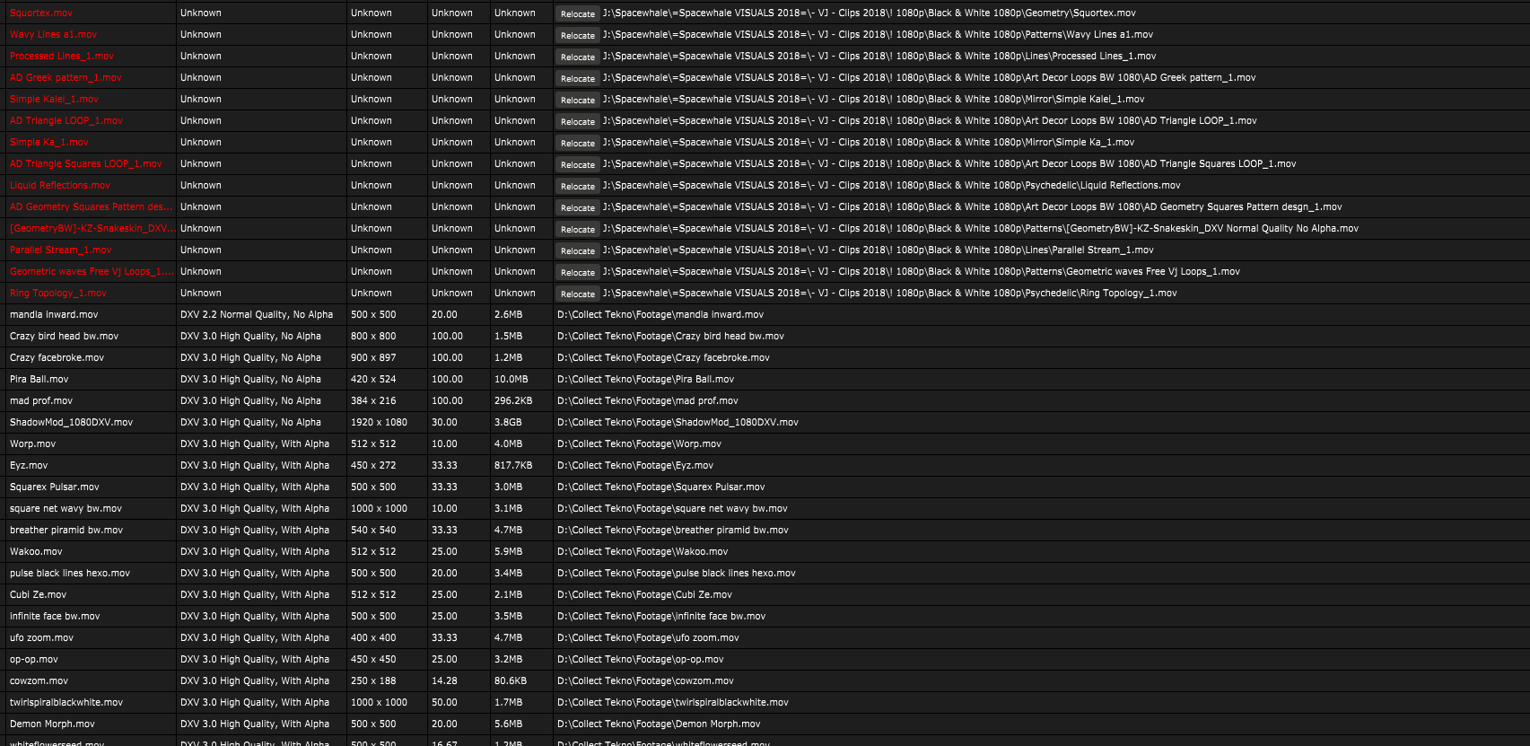

So first 2 screenshots of all the files missing.
If i do a relocate search in the copied footage folder , it does finds them all except for one file.
In the previous attempt there were about 15 files i had to recopy & add , but just one missing is acceptable..

Thanks, are the files you miss or can't reconnect only from the Black & White folder, and all of the files from that folder?
Could be the & that causes issues there.

Not really , as you can see at the top of the second screenshot there are files missing from other source folders aswel.
If the media manager is saying 125 gig but the actual folder is a lot smaller , something is going wrong there ?

In your screenshots all the missing files have a & in the path right?Grimm90 wrote: Sun Dec 09, 2018 22:14 Not really , as you can see at the top of the second screenshot there are files missing from other source folders aswel.
Are these files present in the collected folder?
