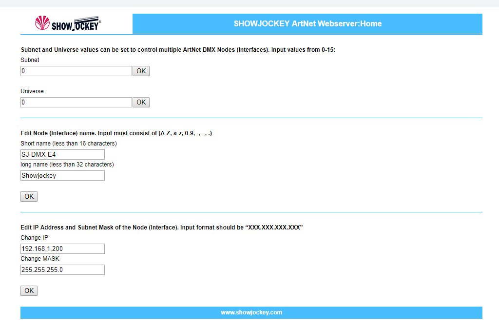

I have Resolume Arena 6, Showjockeys SJ-DMX-E4 dmx-artnet-interface and and Stairvilles RGB led bar (https://www.thomann.de/fi/stairville_le ... chwarz.htm).

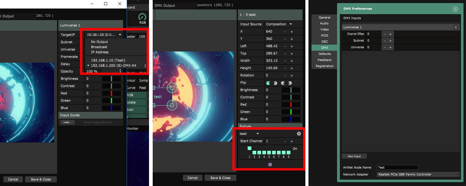

I have IP configurated interface (default IP, subnet 0, Universe 0), created lumiverse (Channel Offset 0, Subnet 0, Universe 0), and set channel from Resolume and from Led bar to 1.

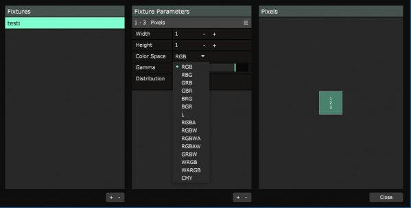

Because things are not working yet I suppose that problem is with Fixture Parameters.
So, how should I set fixture parameters to send correct data to light?

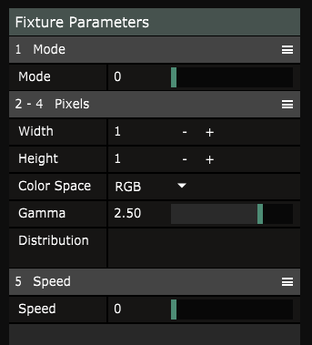

Does this work?:
Stv Rgb led bar.PNG (15.29 KiB) Viewed 5204 times
It looks like it should work with ch 1 Mode and ch 5 Speed set to 0.

Wow, it was that easy!? 8-)
Thanks, now things work as should.
