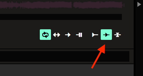

You can use the resync button (map it to keyboard or controller) as a quick fix for jumping back to beginning of any currently playing clip.
Maybe I'm missing something but this sounds like it's just not the right playback switches on the clip?
See attached.
Screen Shot 2019-02-01 at 14.29.28.png (2.45 KiB) Viewed 9514 times
The right 2 determine start point, while the left determine loop and direction.
As for the other issue...
Good practice can be to get used to navigating to the 'active clip' thumbnail in the layers section, it's always there you can't scroll away from it. Clicking it brings the active clip into the clip properties panel.
Currently this thumbnail area isn't mappable, perhaps a good feature request..

Clicking the active Clip in the Layer Panel at the left is the Solution for me. Thanks for hinting in this direction ;)
Still the topic is a little bit confusing.... on contin. Playback the Autopilot will jump to the middle of the clip and also wont start a clip when it was paused before.. strange strange...
~Berlin~
Posts: 7710
Re: Autopilot vs Continues Playback
Auto pilot won't change your clip's settings, so if you had paused a clip, that will be launched by the auto pilot and it will stay paused. With a paused clip the auto pilot won't advance to the next clip any more.
If you select "continue clip from last position" play mode, then indeed when you preview the clip, the last position will be the preview position, so the clip will continue to play from that position when it's launched.
